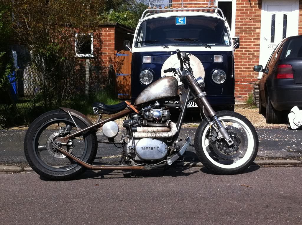

Shakedown 2 success. Was furking about trying to make anbracket to hold the carbs on until it humped me off enough I welded a tab to the spine of the frame and to the carbs top plate. Went up to the fleet lions classic show to see what would happen. It's only 2 miles from home if that so perfect!
Fuellings not right still and will put it down to the jetting as even with the choke on it's struggling to idle and round roundabouts I'm slipping the clutch to stop it cutting out. Guess it could just be the idle needs winding up again.
Got to the meet and hid it in the corner away from the old stuff and instantly got swarmed by people. Managed to get away and just kept glancing over every now and again and it constantly had people round it. The best bit was a family of Gurkhas taking pictures of each other with it. So I guess my bike is going to crop up on someone's facebook somewhere.
http://i1019.photobucket.com/albums/af318/archie_837/fd45a4fd.jpg
Archie's XS
http://i1019.photobucket.com/albums/af318/archie_837/6f35460c.jpg
Archie's XS
I got back and it had cracked my pigeon sh1t welds off the carb tops so needs redoing until I can be bothered to do something else better to hold them on.
Overall not a bad ride. Not as bad as I expected - The springs on the seat absorb a lot of it. It just seems to vibrate through the bars really badly.
« Reply #207 on: May 07, 2012, 05:24:59 PM »
Vertical twin motors tend to vibrate a little! so you should use anti vibration mounts for your carburetors, "Silentbloc" bushes in prefabricated holders work fine. You should also keep in mind that the simple carb. is not an instrument of the Devil, and if you just stick to the very basic principles of carburettor set up, particularly with respect to the effect of main jet size, and its relationship,and overlap to the remaining carb. functions, the need for costly, and often pointless Dyna-whatsit set up becomes irrelevant. You will do no better than acquiring a copy of a very old book called "Tuning for Speed" which should reveal all. I should add "very old" in terms of you youngsters, whereas for me I still have the copy I purchased in the 50's!!! say no more.........Morrag
