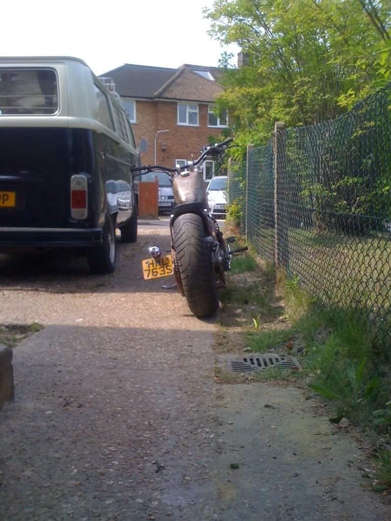

Also please note that in the pic its not on a side stand, but resting on the crest of the driveway.......

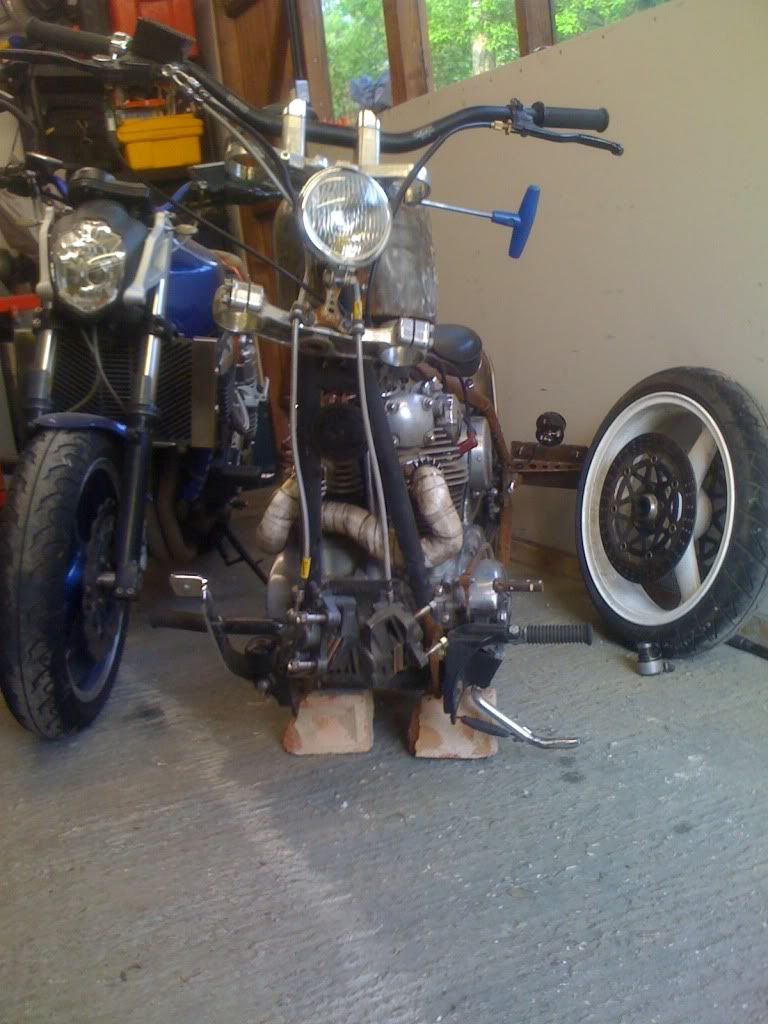

At the start of the day all happy and positive
http://i1019.photobucket.com/albums/af318/archie_837/077078b8.jpg
Archie's XS
this evening after 30 seconds fettling. Fork seals tomorrow
http://i1019.photobucket.com/albums/af318/archie_837/eca29fa7.jpg
Archie's XS
mutter mutter grumble grumble
