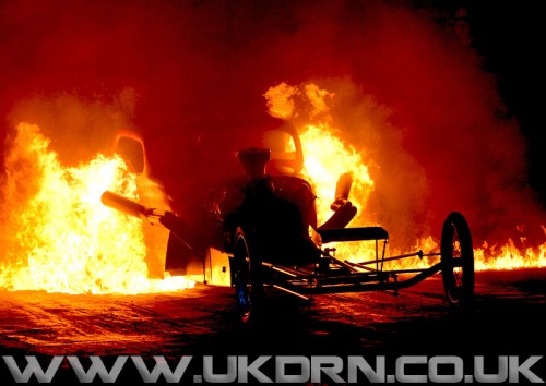

We had taken the body off for Blue so after a very busy Saturday I managed to get booted and suited right at the very end of the day, only to get right to the front and as they were already well over curfew were turned back. I had volunteered to do one of the fire burnouts, so has I hadn't had a run and did not know if the carb was sorted Ian towed me behind the wall so I could give it a couple of blips to try, as there were not problems we took the car back to the pits and fitted the body.
When it was nearly time we went back around the back of the wall to wait until I was called. I have for years (Long before it started again) wanted to do a fire burnout, I was thinking of doing it in the Mini, but knowing that it would all end up inside the body as it never had any tubs I thought it was too dangerous. I did not feel nervous at all and was looking forward to it, so I got myself strapped in and waited for the signal. I drove out from the wall (only to know the ignition switch off to the delight of the crowd as I could hear them) Dave guided me into the water, Kev did the deed of putting the petrol down with Bruno lighting it. I could see the flames on my left and it took a while for it to get right around to the right, I saw Dave signal but stayed a little longer until I could not see through the smoke. If anyone asks how it feels doing it, I cant explain but it put a big smile on my face for the rest of the night.

During the afternoon, Alan from the NSRA came over to me and gave me a box, there had awarded me a Dirty Dozen trophy for the meeting, CHUFFED is a understatement, it put a even bigger smile on my face. Thank you for that, it made my weekend :-)
http://www.cunningplan.net/dirtydozen.jpg
The Cunning Coupe
I few thanks. Dave & Linda, Ian & Brian, Steve & Lesley (He made me a extension for the chute, so all the lines are fitted into the pack (And thanks Norm for showing me how to stow the lines.) Most of all, Blue (& Scott,) don't forget, your booked for next year.
« Reply #491 on: September 17, 2012, 11:21:17 PM »
That's an awesome photo Tony!
