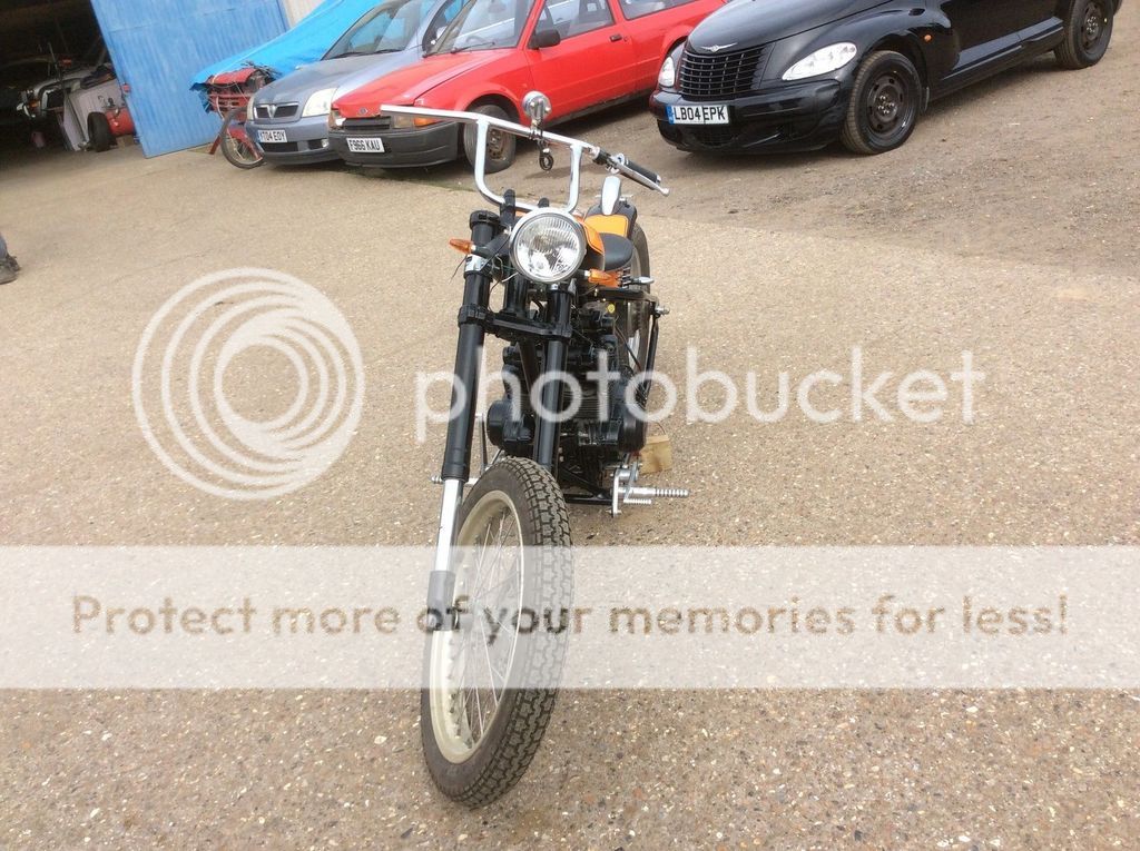

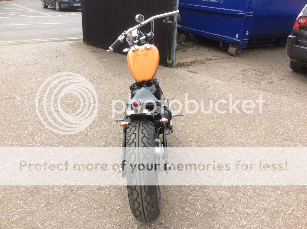

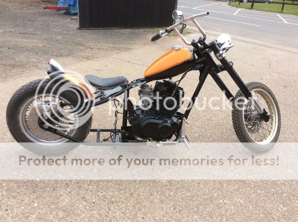

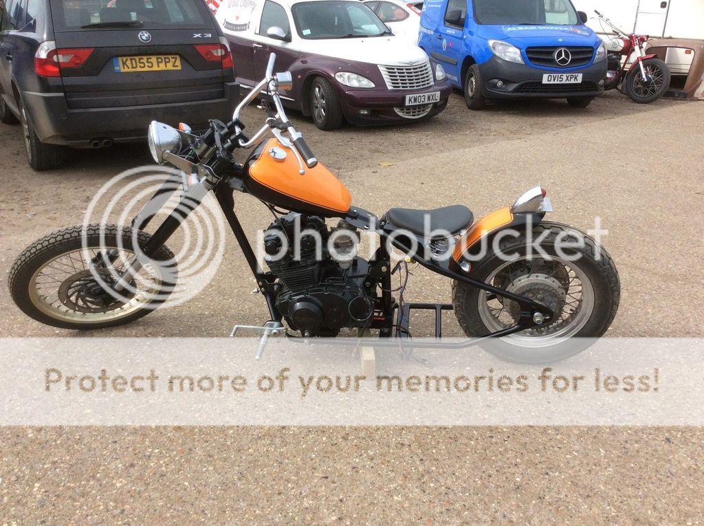

well,  guys,, what do you think   Roll Eyes Roll Eyes Roll Eyes
and who can identifiy  the front end Huh
« Reply #11 on: April 09, 2017, 05:10:55 PM »
i need a front brake caliper and i,v no idea what will fit  Huh Huh

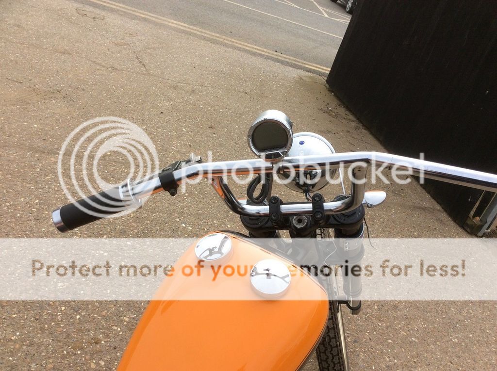

also the speedo is electronic thing  with wires and the sender has got lost  Roll Eyes Roll Eyes
« Reply #12 on: April 09, 2017, 08:13:59 PM »
Front end looks motocrossy Mike, DRZ maybe?
« Reply #13 on: April 09, 2017, 10:05:18 PM »
Very tidy Mike. Did you build it?
« Reply #14 on: April 10, 2017, 09:19:09 AM »
Maybe worth considering modifying the rear torque arm which is currently in compression as oppossed to tension (similar 'concern' to Manky's).  Wink
To quote Sir Manky with respect to his torque arm:  http://www.mankymonkeymotors.co.uk/forum/index.php?topic=7916.msg225106;topicseen#msg225106
The rear brake torque arm needs some modification. Not a lot, but the current set-up means that under really heavy braking it'd be possible for the caliper to move over-centre & swing around the disc. A second locating tab on the frame should fix that.
