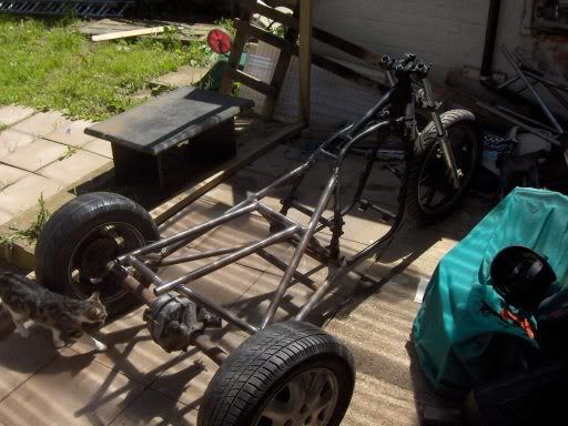

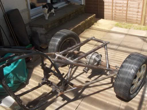

« Reply #56 on: June 05, 2006, 10:03:36 PM »
well i got the frame done ( should have been looking for work  Wink )
hopefully will get the welds looking good this week.

reliantman
Posts: 1265
« Reply #57 on: June 05, 2006, 10:28:13 PM »
Looks ok. Watchout for that cat. Ours are always stealing my tools.
« Reply #58 on: June 05, 2006, 10:28:48 PM »
You're right Reliantman, the 1" bore 4mm wall stuff that we use has doubled in price in the last year.
Frame's lookin' good Baldy! I see you've got a garage cat to give you a hand -what's he like at welding?
baldyshinehead
Posts: 87
« Reply #59 on: June 05, 2006, 10:29:26 PM »
 Grin the daft one in the second pic chases the sparks while i grind,  have to lock it indoors
and its welding is better than mine  Shocked
