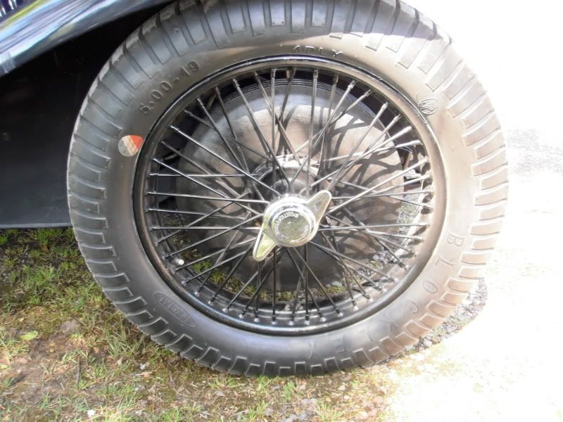

i wanted a set of these - way cool but too bloomin expensive for my taste

coo they are nice mate, wouldn't mind something like that myself Roll Eyes but will prob make do with standard cross ply's Cool Cool

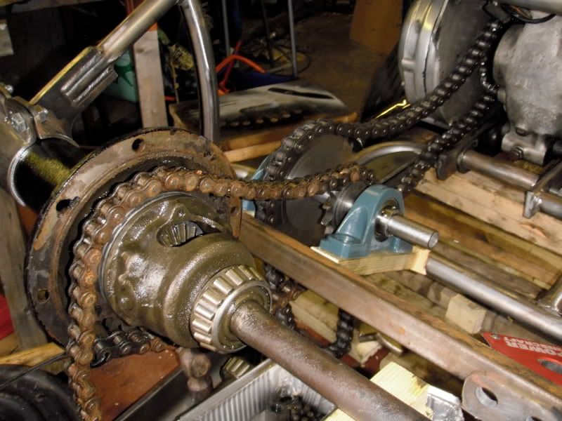

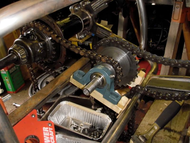

spent the day sorting jackshaft fitting, not going here i originaly planned just behind the gearbox, now moved it back about 8 inches, gives way better chain runs
as for tyres - im probably getting a pair of 450x17 Excelsiors at £80 each delivered, cant find the avon tourists anywhere

« Reply #58 on: June 06, 2009, 06:20:02 PM »
don't think you get 16 inch Pop wheels but early VW vans ran 16, 15 and 14 all in the wide 5 stud pattern and any of these will fit.
blimey Sumo, you must have posted that as I was writing my reply.
The jack shaft is looking good, also liking those tyres but a bit rich for me at the moment.
