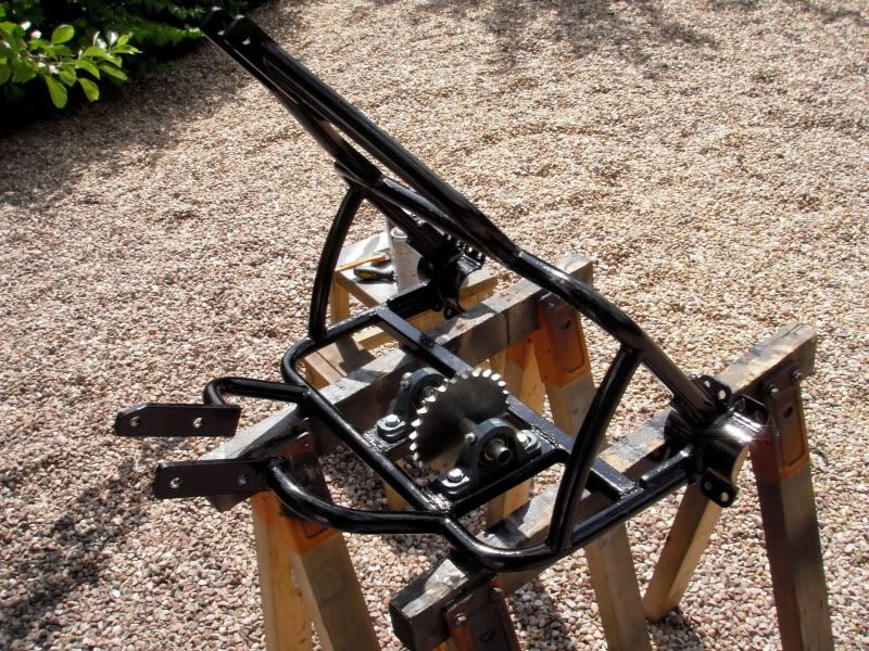

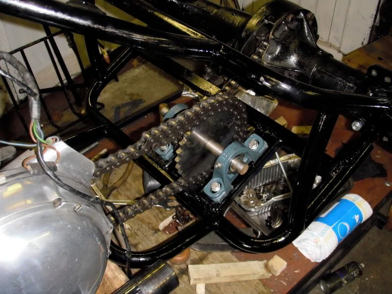

got the jackshaft mounting all sorted, now i just need to make up chain tensioners, rear brake and mounting for box, got a 4 day weekend next week so should get a load of jobs crossed off the list
also got the new tyres mounted and wheels sprayed black, not a bad weekend really
http://i71.photobucket.com/albums/i153/banjodave/panther/P6140002.jpg
SUMOs panther trike
http://i71.photobucket.com/albums/i153/banjodave/panther/P6140004.jpg
SUMOs panther trike

Good work! That looks like some extensive bracketry!

ahh yes - over engineering is always a good thing - and completely in the panther spirit - have you felt the weight of a stock panther swingarm??

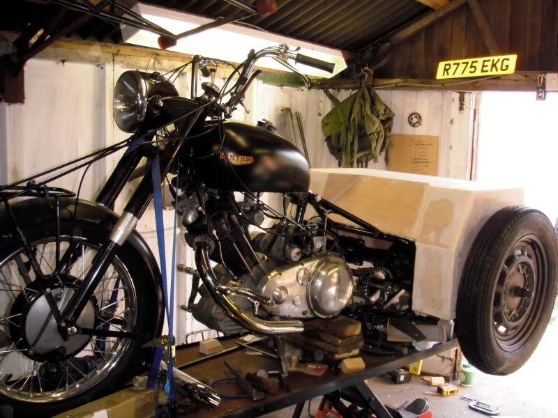

ok so this is 3 days solid work for me and dad
it needs a base and the lid cutting off and a fwe more things but really chuffed

« Reply #68 on: June 22, 2009, 06:13:04 AM »
You should be. That's coming along nicely  Grin
