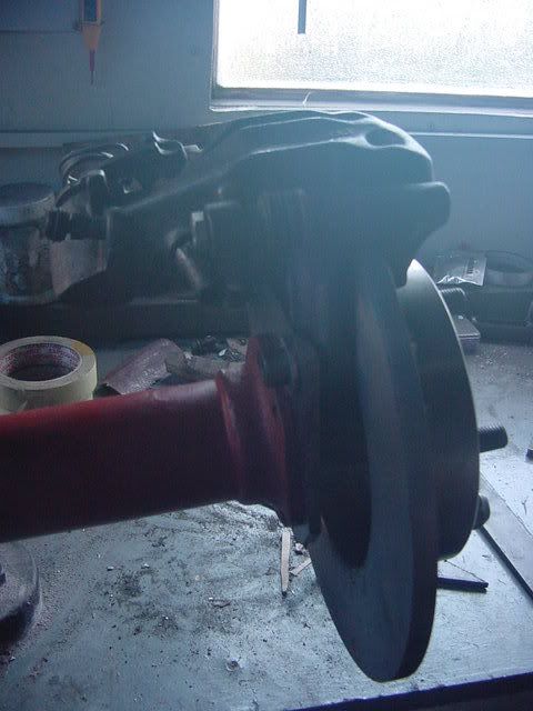

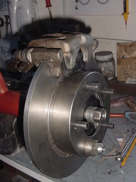

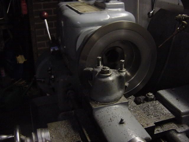

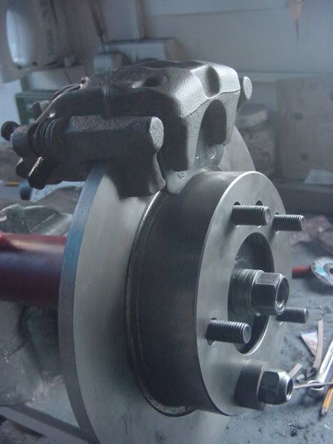

next job was to mount the brake callipers i used vw golf callipers and carriers with BMW 3 series front 5 stud disks.I had to turn the disks down in size to math the size of a vw golf disk that meant turning the diameter as well as the thickness of them

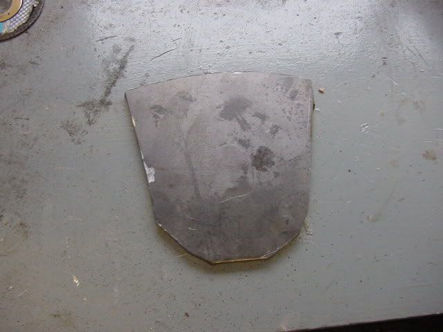

i cut a 6mm plate out to mountn the carriers on it also doubles up to hold the bearing in the axle
then it was a case of bolting it all together

« Reply #34 on: January 16, 2008, 03:51:55 PM »
are you turning down the thickness of the discs or the just the OD ? but the way that bllody good looking cornflakes packets looks right like metal

« Reply #37 on: January 16, 2008, 07:30:53 PM »
hey up m8
ive turned down the thickness as well as the od
they were very thick disks and they are still within the "do not use under a certain thikness limit"  Grin

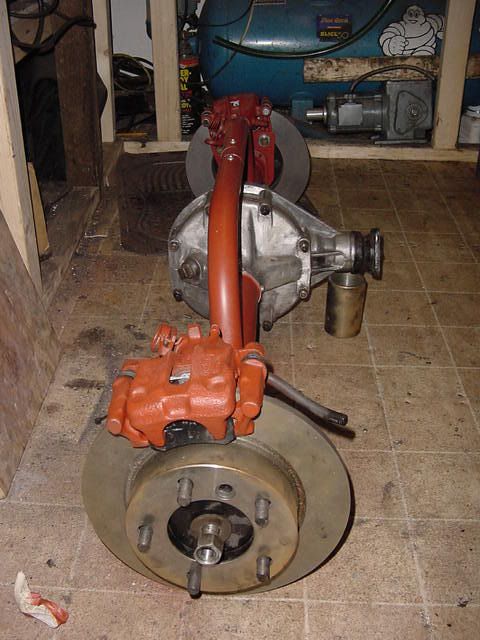

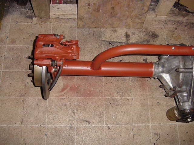

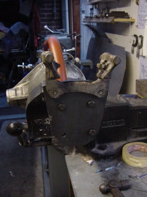

« Reply #41 on: January 17, 2008, 10:02:11 AM »

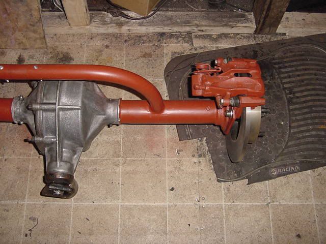

the finished axle
http://i31.photobucket.com/albums/c355/007mouse/new%20trike/DSC00005.jpg
mouse's new trike project :-)
http://i31.photobucket.com/albums/c355/007mouse/new%20trike/DSC00003.jpg
http://i31.photobucket.com/albums/c355/007mouse/new%20trike/DSC00006.jpg
http://i31.photobucket.com/albums/c355/007mouse/new%20trike/DSC00012-3.jpg
Mousy Boy :-) AKA Mick Smiley

« Reply #43 on: January 17, 2008, 02:47:17 PM »
yep excellent work mouse . i tried turning down the faces of a pair of capri twin vented discs before and it never went to plan , i was told later i needed an attachment that wouild allow both sides of the disc to be machined at once to keep them dead true or youll get a wobbly pedal as the two faces will be slightly off from one another . dont know if that helps in anyway nut judging from your last photo all you have to do is attach it to the two pipes sticking out of the yellow machine and hey presto . keep up the good work  Grin
« Reply #44 on: January 17, 2008, 02:52:26 PM »
Very tidy Mr Mouse. Can't fault your workmanship & the results look spot on. Red oxide's a bold choice of colour -it'll look like a motorised baked bean!
