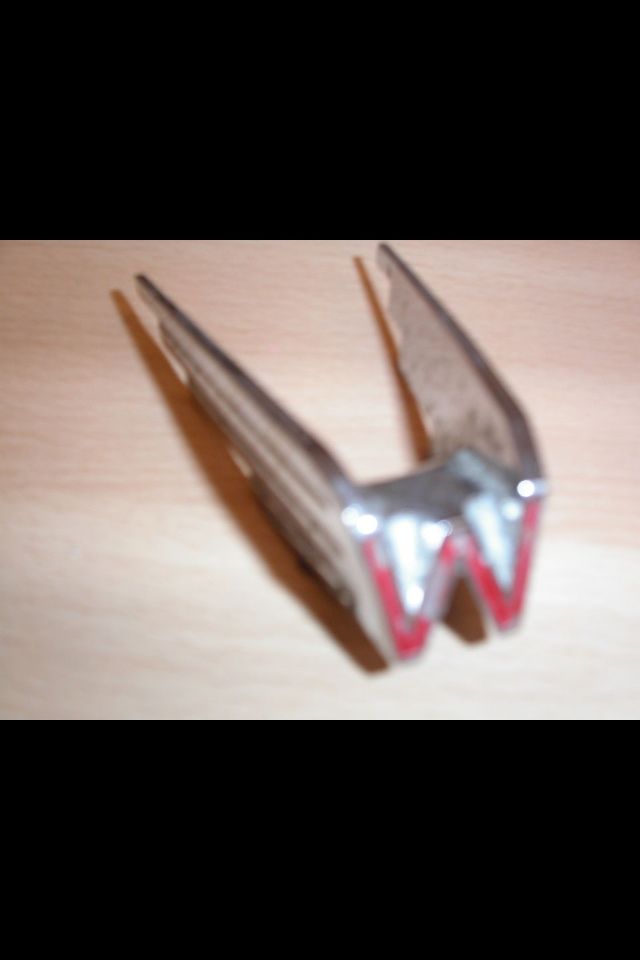

Stumbled across this wolseley bonnet badge (with wings) how bout inverting it for your truck?
http://i1061.photobucket.com/albums/t466/steveatthemorgue/reliant%20trike/211679FA-2E3A-4CAA-A337-B47282661F40-680-00000098358126A5_zpse6654ba5.jpg
Manky's Pop.
« Reply #5641 on: February 16, 2013, 10:13:52 AM »
I've already got a bonnet badge -made by you.
