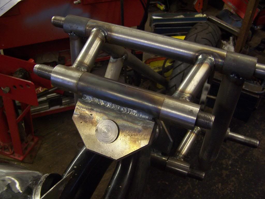

Doh ! Like a complete fool I forgot to drill the pinch bolt hole before radiusing the top slab. After breaking three bits trying to drill into the radius . I ended up cutting the bolt head counter bore out with a hammer and chisel, to give a flat surface to drill into.
One hole drilled tapped and counter bored, 4 hours of swearing at my own ineptitude. Embarrassed
The slot will be cut once the pivot tube is welded on.

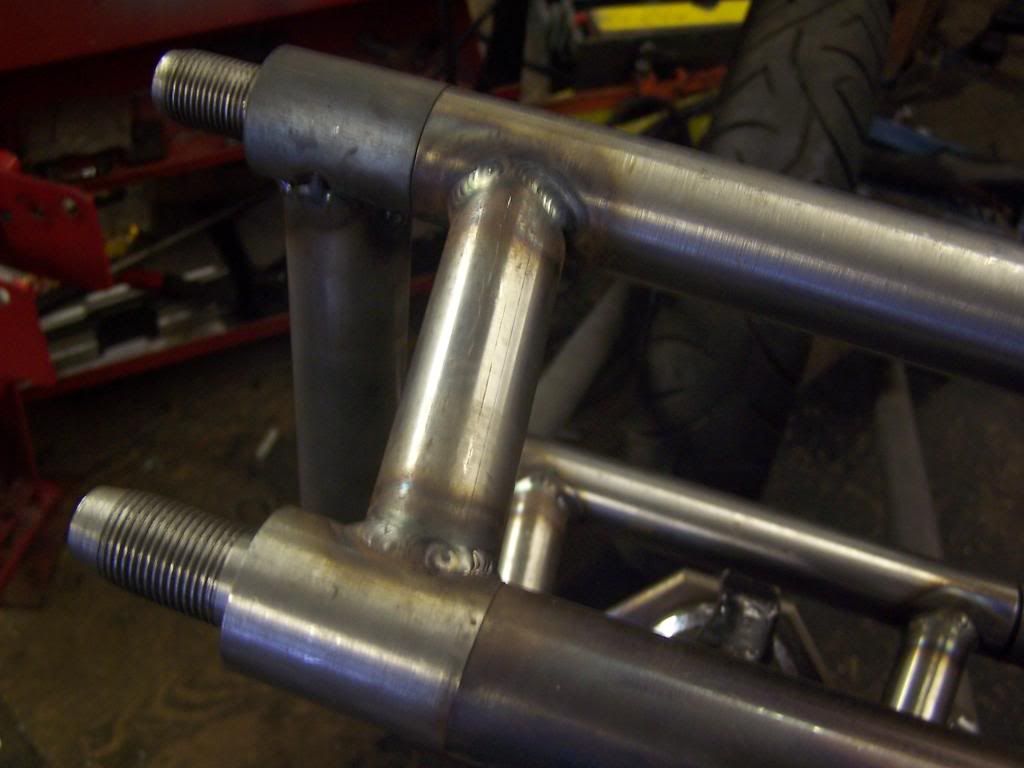

For once, I am sort of working things out as I go along, but the plan is for the links to be bushed and running on fixed but replaceable shafts, threaded each end, fitted into tubes welded onto the yoke slabs ( if that makes any sense ). Bottom yoke tube will be welded to it's yoke once everything is assembled to ensure correct geometry  (hopefully). The reason for bushing the links rather than the yokes is that it allows a larger diameter shaft and makes changing the bushes easier.

Despite the drawing, I am also looking at using single large tubes, as an alternative to the twin tube triangulated setup, but don't think they will suit the look of deliverance Undecided
