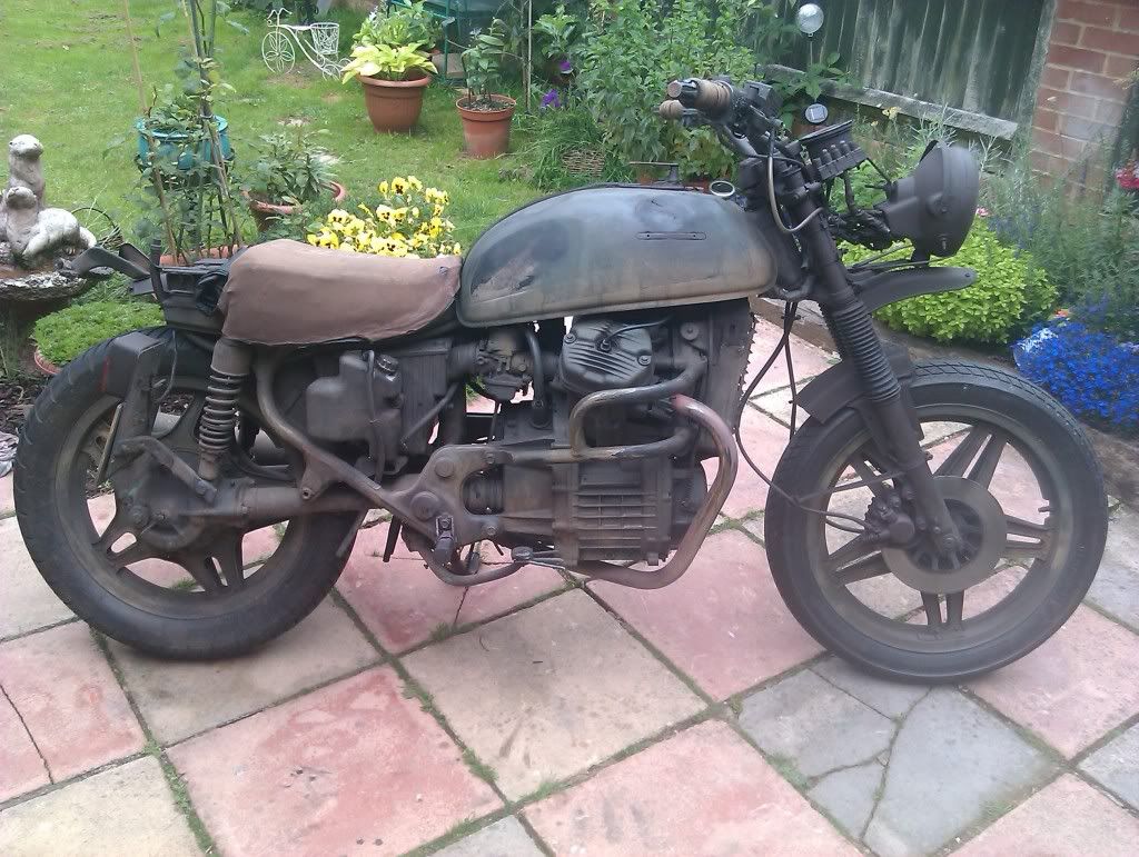

changing my mongrel rat back to old skool bare bones no lights no frills bobber.
Have not been on board for while been busy
Still long way to go petrol tank to finish next .
Re: Have not been on board for while been busy
December 18, 2012, 11:18:46 PM »
Hiya. That's a bit of a transformation isn't it! Love the knobbly front tyre. Not seen exhaust wrap used on handlebars before. It's quite effective.

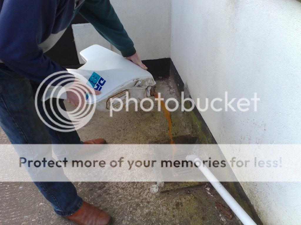

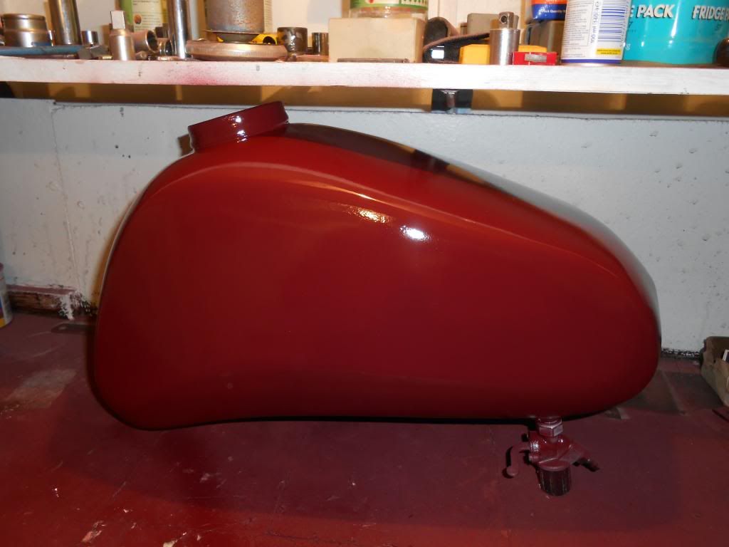

Should have bought better petrol tank lots of dents and rusted inside but after second attempt at painting with rattle cans, ended up like this five coats paint and two of laquer just make sure i park in the shade.
Reply #7 on:
December 22, 2012, 10:58:12 PM »
Unusual choice.

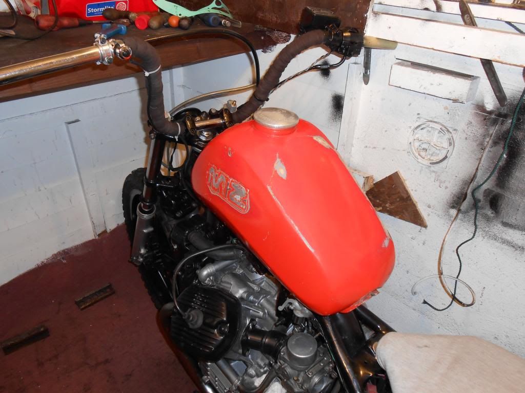

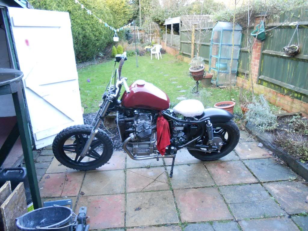

Tank is now on bike love or hate ,might lower rear mudguard bit more work to do onward and upward as they say.
slippery
Karma: 1
Posts: 174
Reply #9 on:
December 23, 2012, 08:03:50 PM »
that's looking good my man

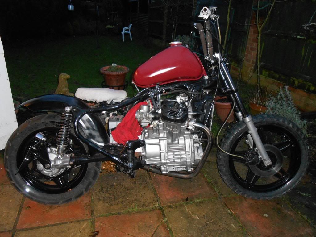

Lowered the rear mudguard so it now follows frame lines.
fifer
Posts: 1116
Reply #12 on:
December 28, 2012, 04:11:54 PM »
I likey , Likey Lots
Reply #13 on:
December 28, 2012, 10:44:26 PM »
Love that short chunky look - you made something different!

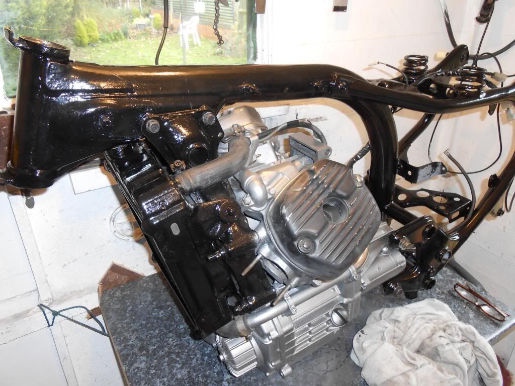

Thanks for the feedback folks i am not building show bike just trying to be bit different on a strict budget thought might let you no so far ,mz petrol tank bought for tenner,yamaha custom front mudguard cut and shut on the back,honda gl500 front forks,homemade riser top brackets,seat base is plywood covered in bit of foam and material,seat springs are cut up shock springs,cx500 engine has done 150,000 miles still on original bottom end and pistons,but have changed stator ,camchain,oil seals,etc rear wheel is cx500 hub on a goldwing gl1100 rim 2.5" 17" diameter ,basic re-wire no lights going to be fitted daytime only did not hardtail because my 57 year old backside needs a bit off comfort.Rear shocks are shortend honda cbx 550 nighthawk.ps monkey the colour is wine red and the bike seems to be starting to look alien not intended.
