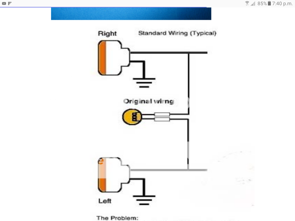

I need help.
I'm changing the clocks on the st1100 to a completely different set.The st1100 ones have a left and a right turn signal idiot lights built into the cluster. The new set has only one turn signal idiot light built in. Would any one know how i can wire the new set up so when i use the left indicator the idiot light would flash and when i use the right indicator the idiot light would flash. I can get it to flash by using one or the other st1100 one fitted to it but when i try to connect the two to operate the idiot light all the indicators flash like hazards. Can any one help.
dr big750
Karma: 10
Posts: 170
Re: rewiring motorcycle clocks
February 25, 2018, 02:48:26 AM »
Merv, try not using a negative earth, feed the bulb with positive power from left and earth with positive power from the right, only works with a bulb, not led, make sure bulb holder is not able to touch negative, will work as a bulb can be fed both ways, and will ground through the unused circuit.
Added on a pic, hope this makes it a little clearer.

Now sorted thanks to the help from this site, i followed what dr big750 advised and it worked

While an indicator lamp between the indicator feeds will work, the right way to do it, and one that will work with leds, is to use a pair of diodes, the anodes to the lamps, with the cathodes connected together feeding the indicator. This stops the backfeed between one side and the other.

Sorry, you totally lost me, without a diagram showing what to do i wouldnt have a clue.
I sort of know what diodes are but what on earth are anodes and cathodes
minimutly
Posts: 967
Reply #7 on:
February 26, 2018, 06:23:49 PM »
The cathode is the end with a stripe around it. No diagram needed, current only flows towards the stripe
