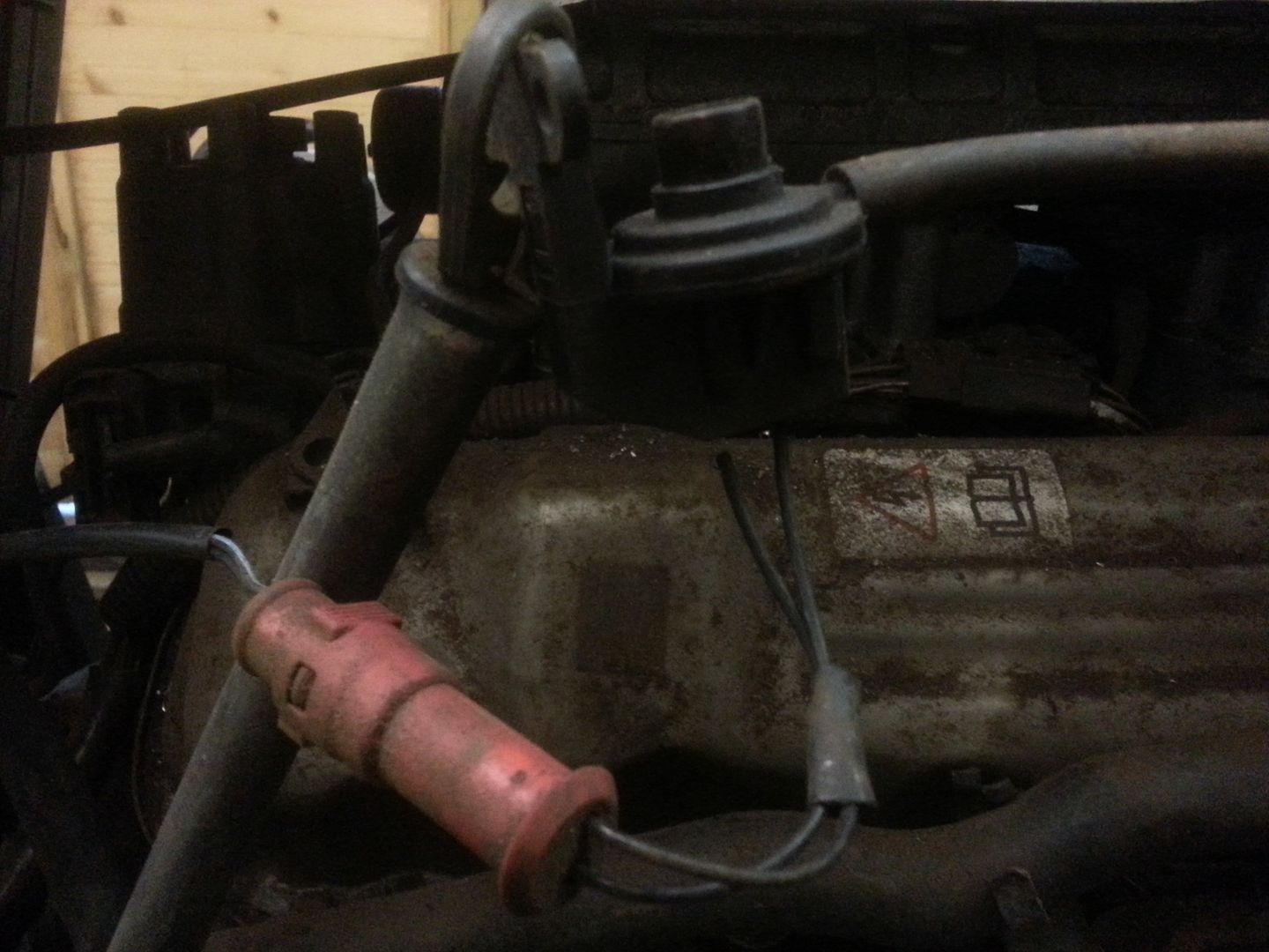

« Reply #6 on: January 28, 2014, 08:50:30 PM »
Can't remember the colours but you have a main relay and then a fuel pump relay fed from that . The blue relay is the kickdown timer relay , at .5 secs it's turns from 'pull' to 'hold to take the current load down.
Hopefully you've also got a relay on a lonish vacuum pipe connector with 2 wires to it ? That switches your overdrive on and off  when vacuum requires it.

« Reply #8 on: January 29, 2014, 04:47:42 PM »
 Grin hi kapri mate is this the vacume pipe you mentchand ? http://i933.photobucket.com/albums/ad179/plockhead1/Mobile%20Uploads/2014-01/20140129_154301_zps1m8fsrk1.jpg

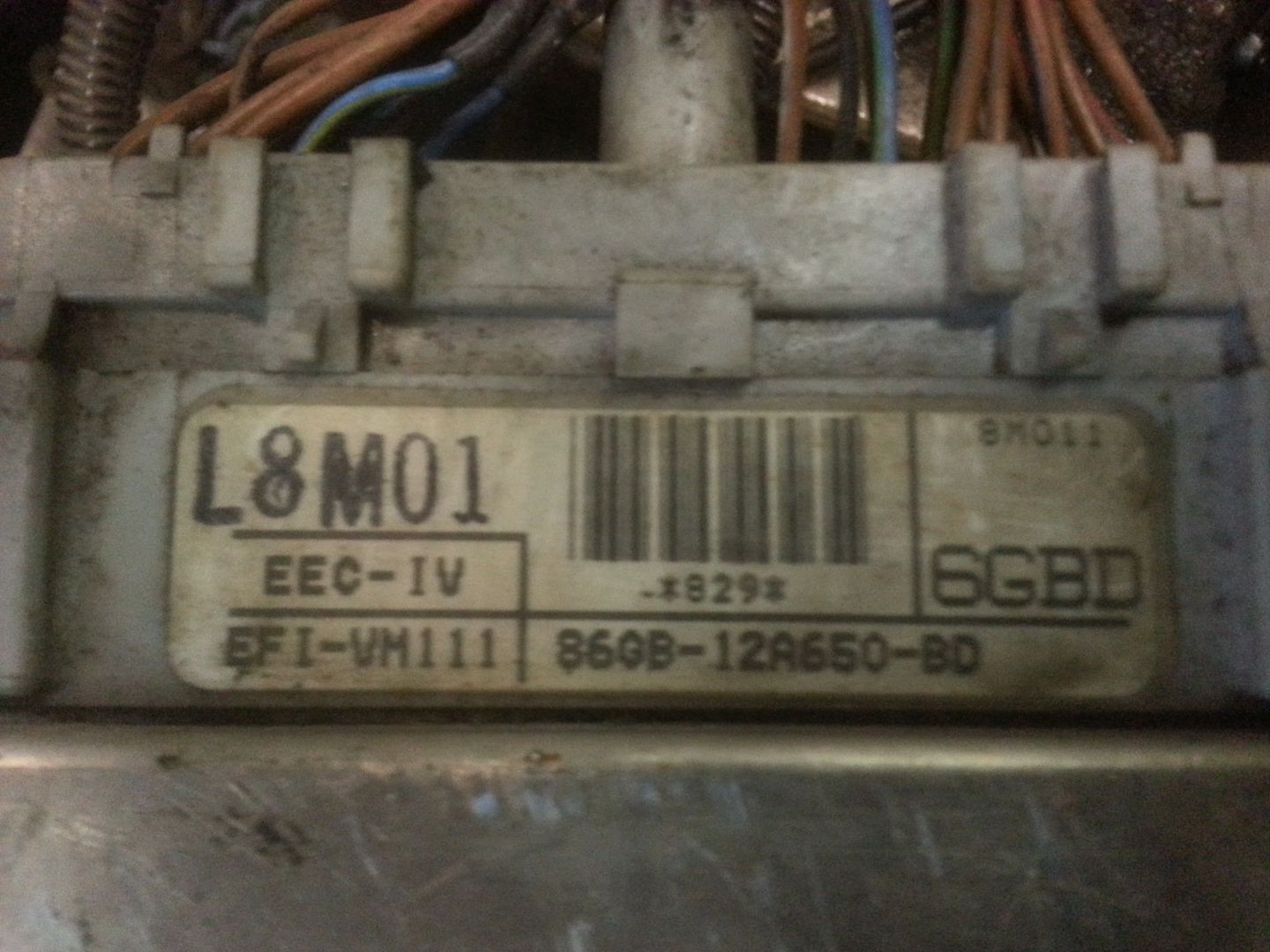

« Reply #9 on: January 29, 2014, 04:55:15 PM »
 Grin have also taken pic of my ecu if that helps your good self http://i933.photobucket.com/albums/ad179/plockhead1/Mobile%20Uploads/2014-01/20140129_155529_zpsdot7deu5.jpg
