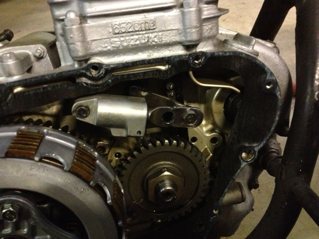

got the engine caseing split tonight and i'm glad i didn't put of any longer
the plunger on the tensioner is at almost full travel max recommended is 17mm
mines about 18  Shocked

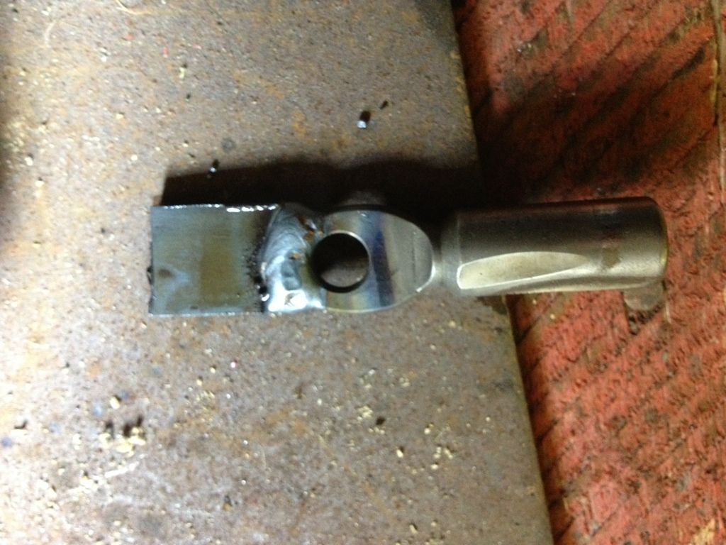

a recognised mod for this is to extend the tensioner by welding a tab on the end
and drilling a new hole to mount the guide so thats probably the way i'll go with it

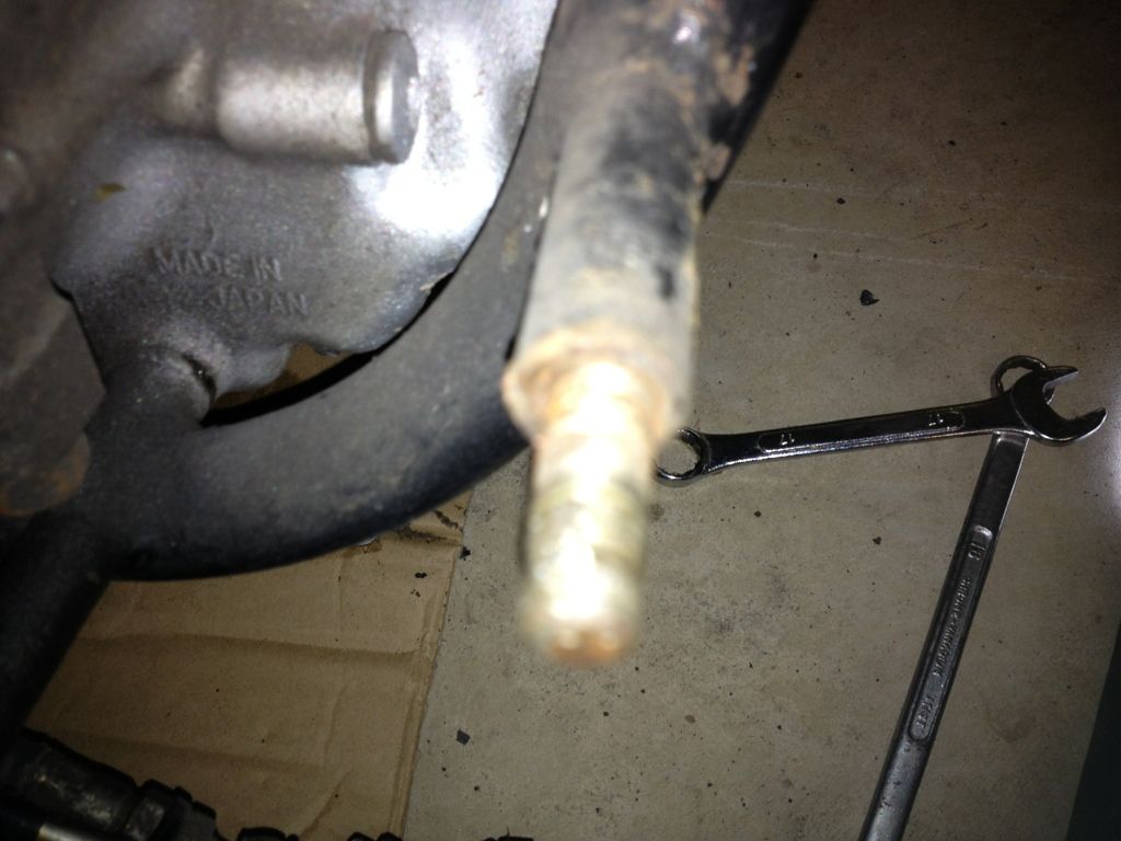

also the oil leak does seem to come from the bolt as higher up on the engine is dirty but dry
apparently this bolt needs to be done up really tightly to stop this form happining

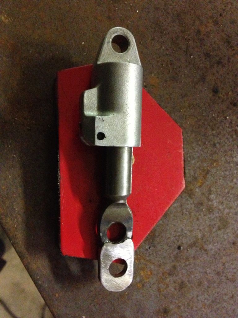

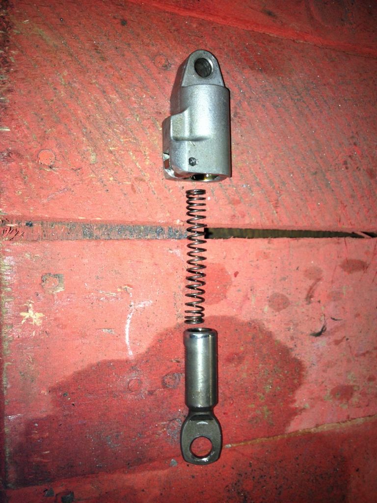

this is the tensioner in bits ready for it's new extension
http://i1056.photobucket.com/albums/t373/Eddie096/A9126B7B-7BD7-48EE-AF10-B784C4A3CE4E-15464-00001E2323F657AD.jpg

there's a little bit of wear on the teeth of the tensioner shown bottom right,just in front of the machined
area. does anyone think this would be a problem or suggest a way of cleaning them up

timing chain tensioner modified with an extra hole doubles the life of the chain
hopefully get it refitted tomorrow

we have come to the conclusion thet this tensioner has already ejected from the housing (see earlier photo)
from the wear on the side and teeth and also a mark on one of the gears.
this is on a bike with only 22,000 miles on it and which i have owned for 8 years so this must have happened
before that when i got the bike it ad about 15,000 on it so BEWARE anyone with a savage,check you timing chain
tensioner at least every 5,000 miles

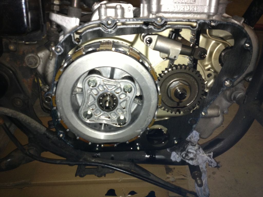

anyway modded now and here's the pics

« Reply #13 on: February 17, 2013, 06:23:58 PM »
Hi Nabsim
it seems to be a design issue with the tensioner my chain has about .25 inch of play,the accepted max is .75
so this modded tensioner is surposed to give the chain it's full life.I will now however be keeping a close eye on
it to see how this play's out.
     According to the guys on the savage forum in the states it's not unknown for the tensioner to eject at
between 5 and 10 thousand miles especially if it has been used a lot on short journey's,a fact possibly bourn
out by the appearance of my tensioner
