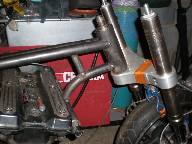

I tried to use a bit of common sense with some things, I bent up the 2 top tubes, they were welded side by side and then I sat it in place and worked out headstock angle etc, this in turn told me the angle of cut I needed across the end of the tubes to fishmouth over the headstock
so I made the headstock a nice size to mate up to the ends of the 2 tubes, put the top tubes of the frame in a mill, and using a milling cutter the same dia as the headstock (lol you shuold have seen that coming), I cut the notch, obviously making sure the tube was vertical and mill bed flat etc etc
I then knew that the headstock was a good fit into the slot, it was straight in relation to the backbone and off I went on my merry way making smoke and sparks

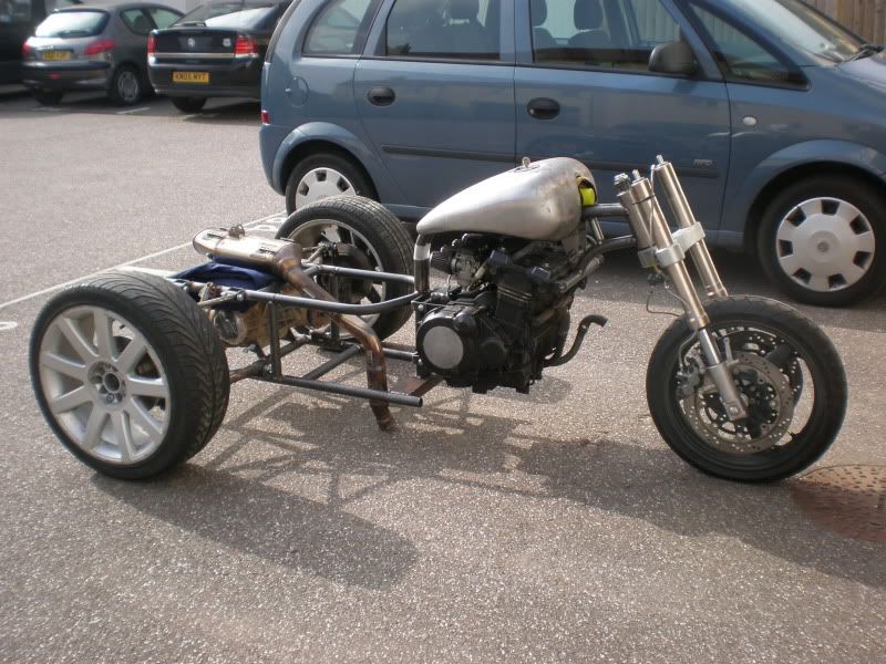

the very first time it rolled out into daylight

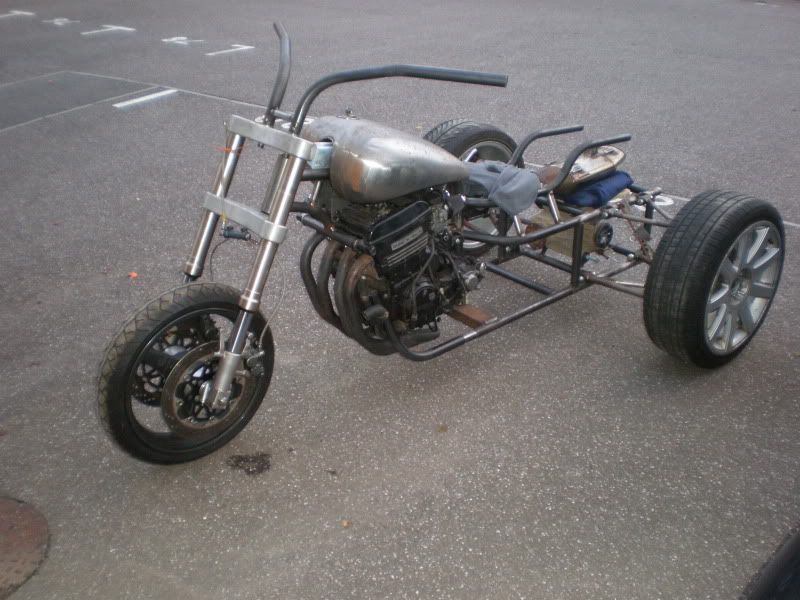

then got onto the seat rails and removable front frame section
