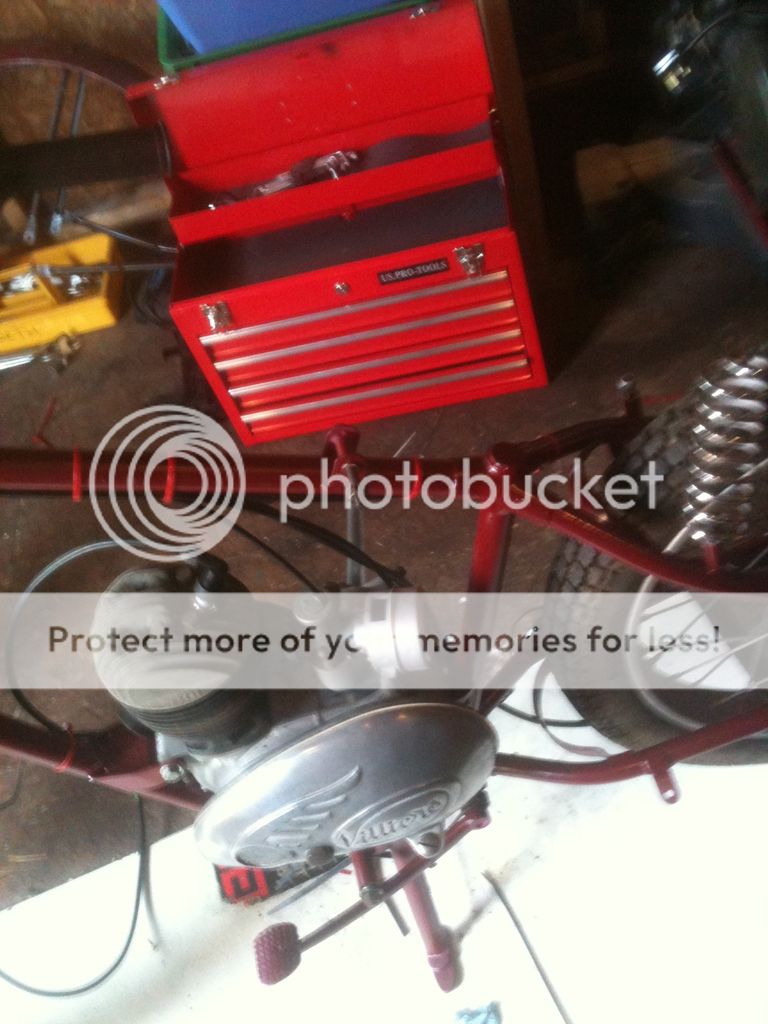

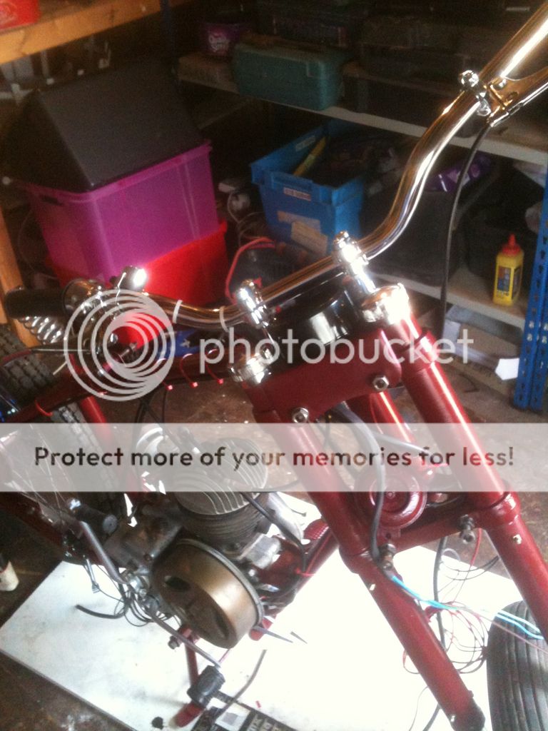

« Reply #8 on: August 11, 2015, 09:31:08 PM »
Well coming along nicely. Started after just three kicks. Not bad seeing as it's not been started for thirty years.
Spraying is all done. I've learnt a hell of a lot doing my own spraying. Big list of do's and don't's. And that's why we do these things to learn, not just to keep out of the wife's way. Smiley And it's fun of course.
Hopefully another good days work or so should see it ok for a test run or two. Then I will have to have the wheels off as both tyres are well past their best. Also where the wheels have been re spoked there is a bit of run out on both so that needs sorting. And little things like finish the wiring, check its charging so on. Have to keep reminding myself I'm not in a race and to slow down a bit. Also need to do a major tidy up of the trike but that's going to have to wait for a bit. Hopefully pictures of the restoration to date are below....
