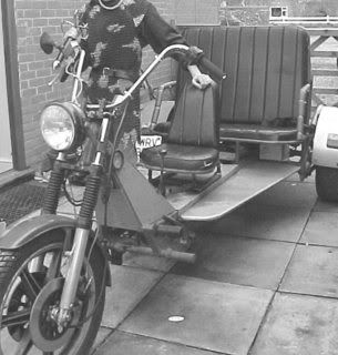

Thought I'd put up some pictures of my trike build.
Originally got the trike in 99, when it looked like this
http://i25.photobucket.com/albums/c53/strangely-made/Image2-1.jpg
My Trike

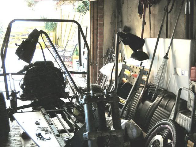

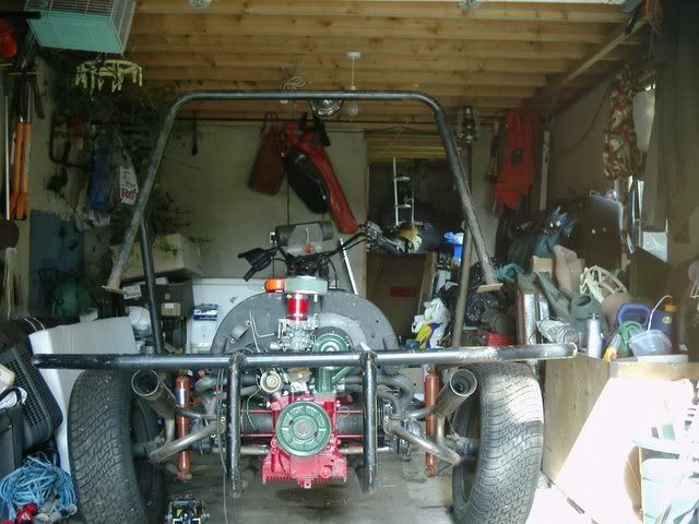

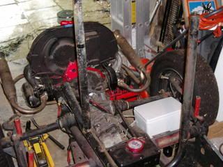

New engine in, and a roll cage sitting on the frame
http://i25.photobucket.com/albums/c53/strangely-made/trike2.jpg

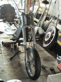

An idea I tried out for the front end
http://i25.photobucket.com/albums/c53/strangely-made/trike4.jpg
My Trike
Rear view with the roll cage partly fitted
http://i25.photobucket.com/albums/c53/strangely-made/trikeframe.jpg
My Trike

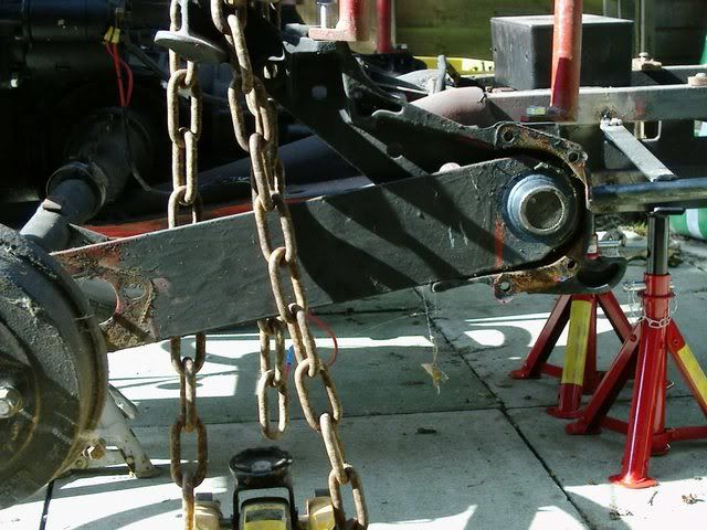

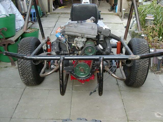

I'd also joined the Baja club, so decided to modify the trike so I could play with the club at our permanent play ground at Santa Pod
Raising the rear
http://i25.photobucket.com/albums/c53/strangely-made/trikeduring.jpg

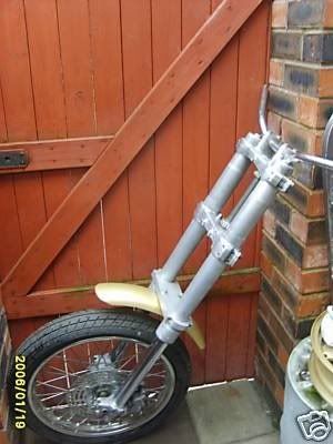

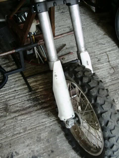

Bought some new forks, came from a chop and the guy told me they were from a KTM, turns out they are actually off a 91 Cr250 so even better.
http://i25.photobucket.com/albums/c53/strangely-made/aaaaaaaaatrikeforks.jpg
My Trike
And fitted to the trike
http://i25.photobucket.com/albums/c53/strangely-made/Trikey3.jpg
My Trike

The rear wheels were a bit small,
http://i25.photobucket.com/albums/c53/strangely-made/trikewheel1.jpg
My Trike
So bough a pair of 15" weller 8 spokes off a club member. Much better, and give me about 14" ground clearance
http://i25.photobucket.com/albums/c53/strangely-made/trikewheel3.jpg
My Trike

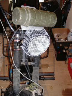

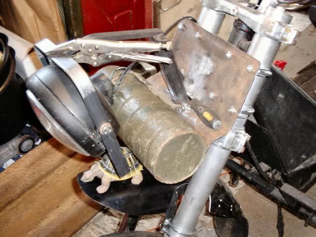

Tried out a headlight mount I made, not pretty, but was bloody strong, could lift the whole trike with it.
http://i25.photobucket.com/albums/c53/strangely-made/mudguard4.jpg
My Trike
It's not staying though, got some smart new lights custom made by a mate, but they'll be the last things to go on.

« Reply #4 on: June 27, 2010, 06:00:33 PM »
Nice little build up your wheels are a bit of camber try shifting it by turning the rear arms a couple of splineshad to do that on my Albar beach buggy

« Reply #6 on: June 27, 2010, 08:25:56 PM »
Nice little build up your wheels are a bit of camber try shifting it by turning the rear arms a couple of splineshad to do that on my baja beach buggy
Yep, bit of camber there, partly because I've put about an extra 16° 20' (roughly) in by turning the spring plates round two outer splines, standard practise in Baja's. It'll even out enough with the engine, seats and fuel tank in.

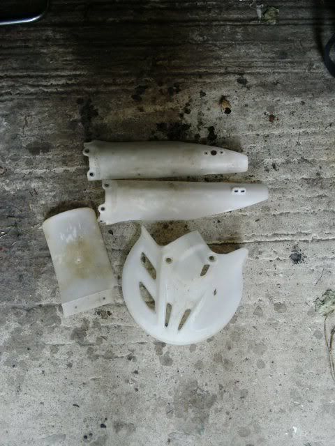

Look what I got today

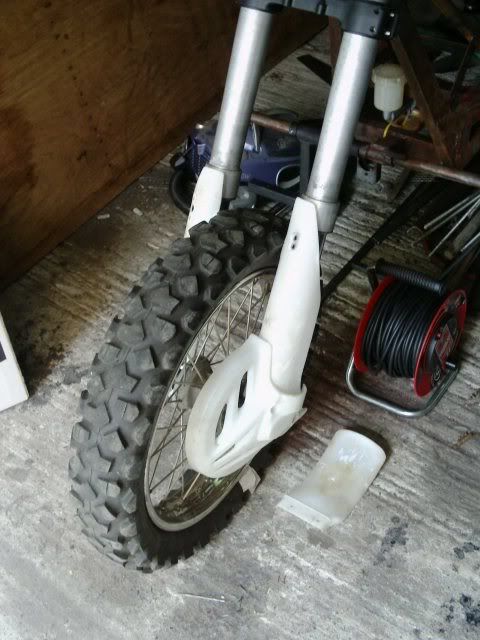

http://i25.photobucket.com/albums/c53/strangely-made/plastics2.jpg
My Trike
Not very exciting, but they are from a cr ten years newer than the cr that the forks are from, so will need a fair bit of modding to make fit. Plonked them on the forks today, just to see how they look and there is a good weekends work there to sort them out.
http://i25.photobucket.com/albums/c53/strangely-made/plastics.jpg
My Trike
http://i25.photobucket.com/albums/c53/strangely-made/plastics1.jpg
My Trike
Hopefully should help protect the forks and seals a bit green laning and playing off road.

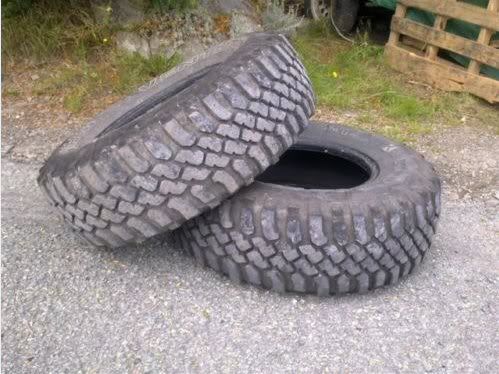

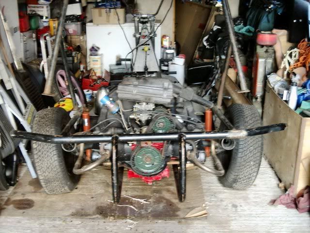

HaHa, look what I bought today http://i25.photobucket.com/albums/c53/strangely-made/tyres2.jpg
My Trike
31x10.50x15 MTs, should be fun watched Colin round the garage squeeze them onto 7" wide rims Smiley Then, I'll have to paint the wheels. And now that the harvest is almost over, I'll actually be able to get out to the shed and do some more bodgeing building.

Nice one Mr Strangely.
What are you going to do about uprating the Brakes?  I suspect with those wheels/Tyres you will need too increase the stopping power a wee bit due to the leverage increase
http://www.choppit.co.uk
Strangely Made
Posts: 81
« Reply #13 on: August 06, 2010, 10:31:51 AM »
I'm going to change the slave cylinders in the drums from the stock rear ones to front ones. They're larger so should work fine, or at least that's the theory.
ByzMax
Karma: 57
Posts: 1637
Choppit
« Reply #14 on: August 06, 2010, 11:44:14 AM »
I put 67 type 3 (I think) on the pheonix (22mm) as no mods are required and the bleed screw end up above the pipe like it should. Worked ok but those tyres look a tad bigger.  Wink
