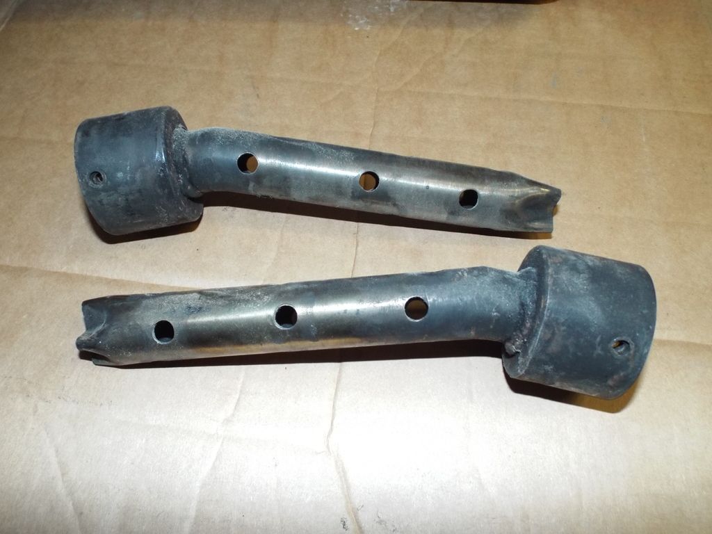

http://i1236.photobucket.com/albums/ff441/TLSADE/DSCF1851.jpg
Manky's XS650 Yamaha
http://i1236.photobucket.com/albums/ff441/TLSADE/DSCF1849.jpg
I made these for my TL1000 race cans cos they were thumpingly harsh. They are only 8'' long but work really well for reducing the hash noise level. Even went through M.O.T. with these fitted!

So, my learned friends, I'm curious -would the spirally, screwy thing work & what effect would it have on engine running, (back pressure, pulsing etc)? Worth a go?

I think ( so this is a guess at best) that to quieten an exhaust you have to deflect or break up the pulse, some performance back boxes I've seen cut up have two tubes at opposite sides that are not connected, ends blanked off ( usually squashed ) and the exhaust air passes from One tube to the other by the small holes/ perforations in them, so I think yes it would make less noise but you can only test it to be sure, does seem expensive unless you could make a spiral your self?

Also I recon that whilst it may slow the flow, it won't actually break up the pulse so not giving up any noise and yes it could whistle  Grin I'd like to see the results though,
Other one is vw baffles the short exhaust end pipes are internally baffled, years ago a mate had a bonnie that ran them, I don't have a set to loan you but could ask around the vw crowd?

I've tried these several times over the years, but never had any success with them.
« Reply #1709 on: January 06, 2017, 07:58:45 PM »
VW "Cannon" baffle.
