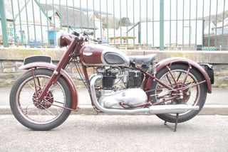

« Reply #148 on: October 11, 2010, 08:05:45 PM »
This is a real Bike. an original Bobber.
http://i290.photobucket.com/albums/ll259/spares_photos/Picturewhatamess014-1.jpg
Manky's XS650 Yamaha
« Reply #149 on: October 11, 2010, 11:36:16 PM »
Tis jolly nice too mate.
Thanks Tony. I'll be buying a pair of long trumpets, (trombones?), then.
