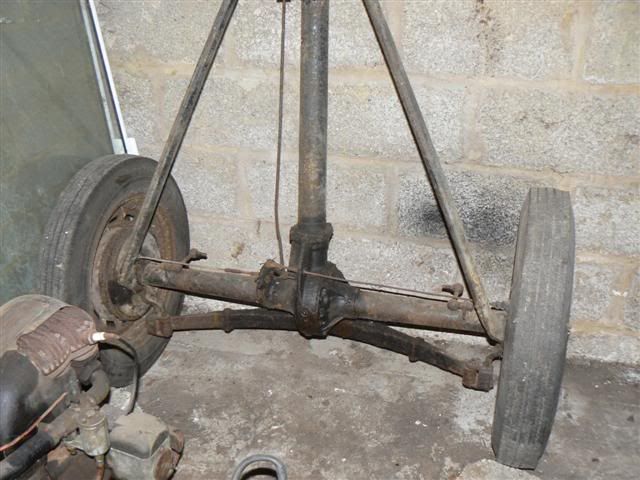

cable, no new clean pics - its underneath - heres old dirty pic

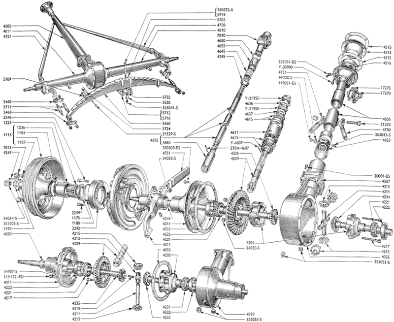

but its just a standard cable setup, nothing fancy. and as i say its not anything outside the wheel like routing etc as it all functions great till the drum goes on - see diagram all well till i put on drum [1115]

Drum not true? -oval, rather than round?
Or the braking surface inside the drum tapered rather than true & square to the face of the shoes?
A lip worn on the back edge of the drum? I once had a problem on one of my Moggy Minors -the drum would pop on over the shoes but the braking surface had worn down, leaving a lip around the back edge. When I braked hard the shoes would ride up onto the lip & jam on.
Excessive scoring of the braking surface of the drum, causing the shoes to "stick" to it?
Is the operating cable properly anchored to the back plate? Maybe the outer sleeve is pulling out of the back plate when the inner cable moves & holding the brake on?
If yo've got access to a lathe, it's probably worth spending a few minutes spinning the drum up to check it's running true.

Have you got an exploded pic of the brake system? How do the shoes operate, do they have return springs fitted?
SUMO
Posts: 300
« Reply #14 on: January 04, 2010, 05:00:55 PM »
yep return springs fitted - they are much the same as any drum brake with the 2 springs across the middle.  they work and return just fine without the drum on  Huh
