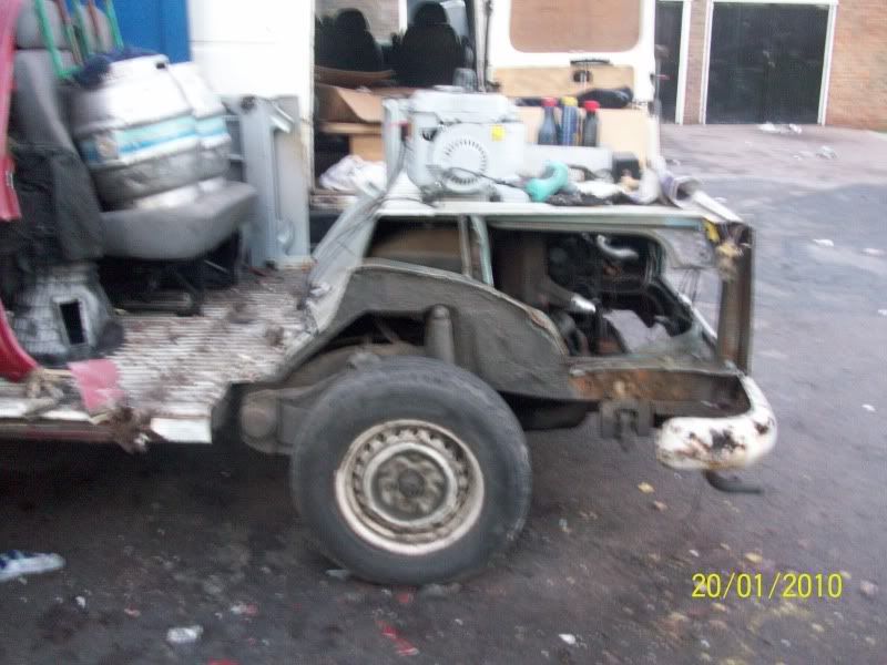

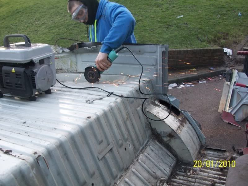

« Reply #22 on: January 17, 2010, 10:04:09 PM »
Done a bit of cutting while the sun was out today, slowly getting closer to the engine Smiley
http://i131.photobucket.com/albums/p316/thrud2011/100_0679.jpg
vw trike
http://i131.photobucket.com/albums/p316/thrud2011/100_0680.jpg
vw trike
I was cutting so dad was behind the camara, sorry 'bout the quality
« Reply #23 on: January 17, 2010, 10:26:31 PM »
I'm sure he's a very high quality Dad.  Grin
There'll be V Dub owners weeping over those photos!

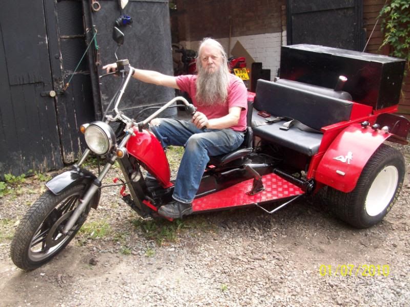

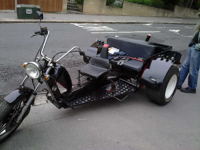

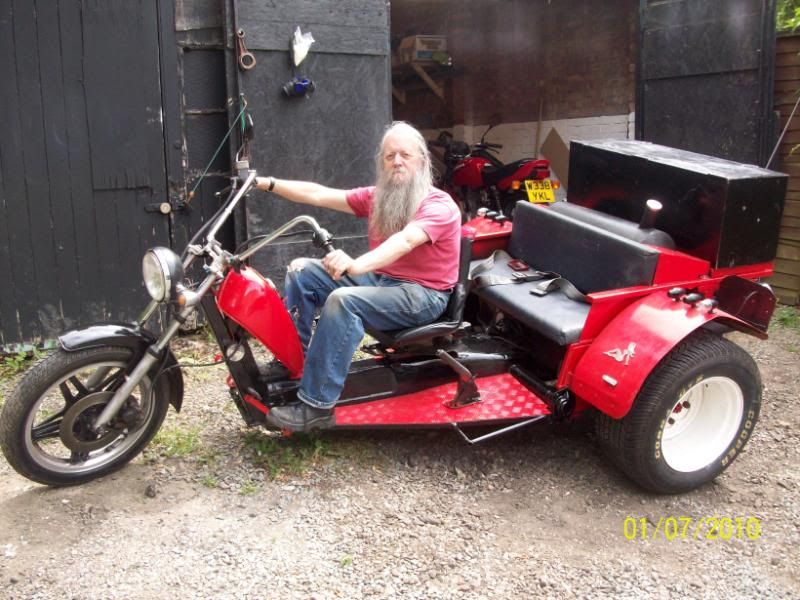

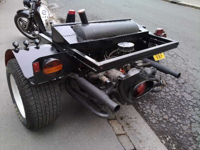

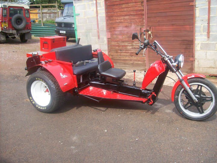

« Reply #26 on: July 13, 2010, 09:39:22 PM »
Things never go quite to plan,
regardless of family prob's, dad still wanted to get his hands on 3 wheels,
so started hunting through ebay, and found this
http://i131.photobucket.com/albums/p316/thrud2011/trike1.jpg
vw trike
it does have some teething prob's, but dont they all Grin
here's a few shots of dad on it
http://i131.photobucket.com/albums/p316/thrud2011/100b0880.jpg
vw trike
http://i131.photobucket.com/albums/p316/thrud2011/100_0856.jpg
vw trike
http://i131.photobucket.com/albums/p316/thrud2011/100b0870.jpg
vw trike
since getting it home, it's turned black
http://i131.photobucket.com/albums/p316/thrud2011/13072010048.jpg
vw trike
http://i131.photobucket.com/albums/p316/thrud2011/13072010049.jpg
vw trike
« Reply #27 on: July 13, 2010, 10:30:15 PM »
That's a seriously hairy Dad!
Welcome back Thrud.
Strangely Made
Posts: 81
« Reply #28 on: July 14, 2010, 12:18:36 PM »
That is a nice little trike, is that a type4 engine in there?
« Reply #29 on: July 14, 2010, 03:02:26 PM »
t3?
