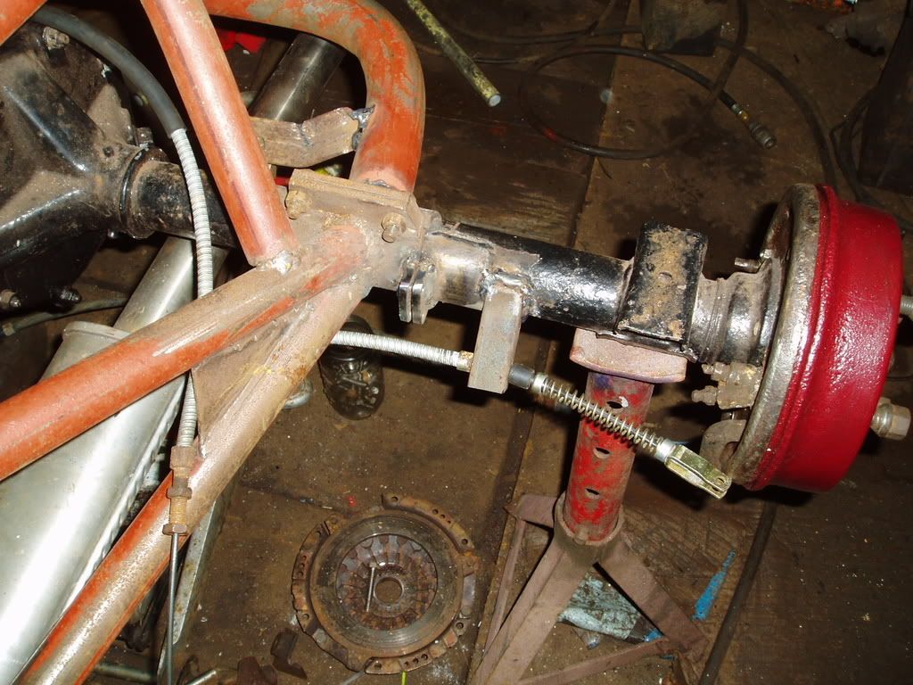

I agree, but what I meant was, that the slave cylinder should sit the right way up or it would be hard to bleed, so spinning the back plate around, it would sit the right way up, but would with the handrake lever would be at the back (Hence swapping them side to side if that was a problem)
http://i267.photobucket.com/albums/ii305/rickyzetec-s/P2040014.jpg

« Reply #10 on: October 15, 2009, 08:30:46 PM »
well  do you know something Grin Grin Grin Grin ,,,,,,,,,,,,, i think i,ve seen that somewhere  Grin Grin pmsl
