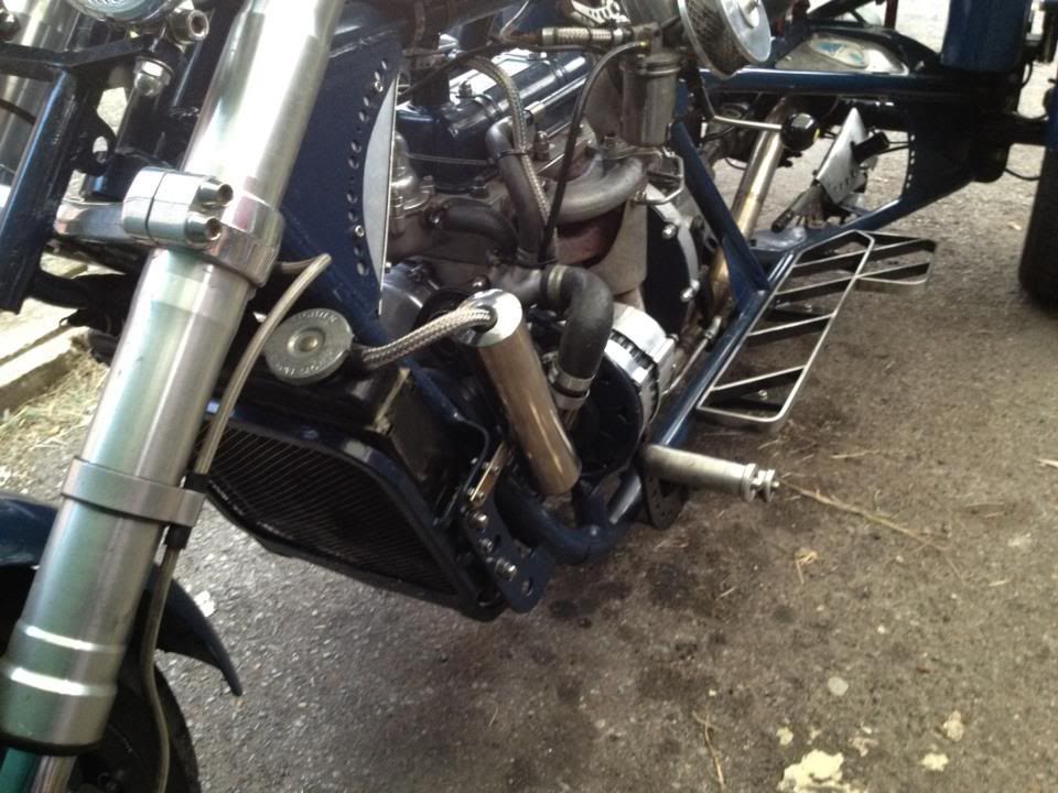

Fitted a tank to the side of the rad today,with pipe going right to the bottom inside. Its a lump of 50mm diam tube with a cap at each end. The bottom cap is fixed(glued in!),the top cap is loose fitted.Will top it up about half way with coolant ,and see what happens when the rad splutters out . At the very least it will stop me and the trike getting sprayed with water! We'll see!

almost the same as mine, works great

Looking really good , Rod  Smiley
As long as atmospheric pressure can get in / out the cap then that setup will be the bees knees  Grin

 The cap is aloose fit in the tube Pete,plus theres a air gap round the pipe where it goes through the grommet. Next thing is to put a t piece into the hose that runs from w/pump to rear of block.Cant find anything that fits the heater hose(12mm id) so think I may remove the solid tube that runs beside the rocker cover and T into that and fit a removable plug in the top.The tube is steel,so I'll be able to weld something on to it sticking upwards @90 degrees.
« Last Edit: September 09, 2012, 08:36:16 PM by ROD » Logged
« Reply #895 on: September 09, 2012, 11:12:59 PM »
For bleeding the air out? You could use a brake bleed nipple.
