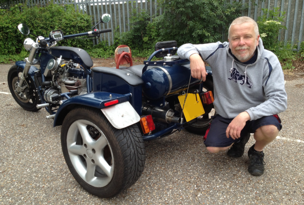

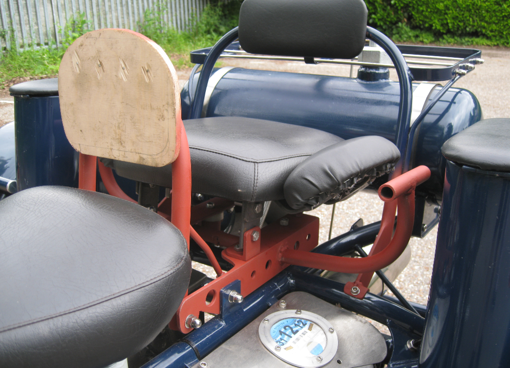

This pic shows the work Ive done to raise the rear seat and to incorporate a backrest for the 'steerer'(!)
 I made it all adjustable to tweak it if needed ,then paint it when finally done.  I pulled it all apart again today to add the 2 hand steady bars,and also make the front backrest panel tilt forward,as SWMBO couldnt get her little legs and trotters over the top of it Roll Eyes Shocked! It now tilts forward ,and eventually will be held vertical by one of those powerful magnet molybenum thingys.I m going to upholster the panel later. I will cover the gubbins below the seat at a later date.Had trouble with the welding,as can only use one eye at present!
 http://i956.photobucket.com/albums/ae49/HJody92/daddddd.png
RODS build........

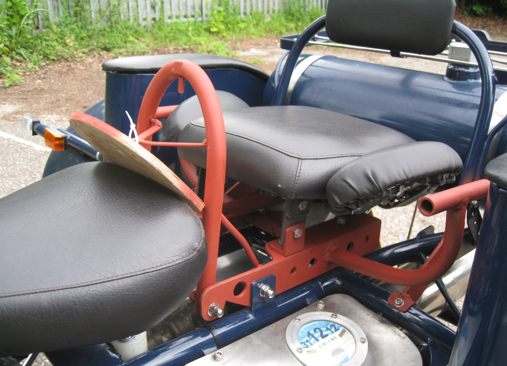

 This shows how it tilts...
http://i956.photobucket.com/albums/ae49/HJody92/d.png
RODS build........

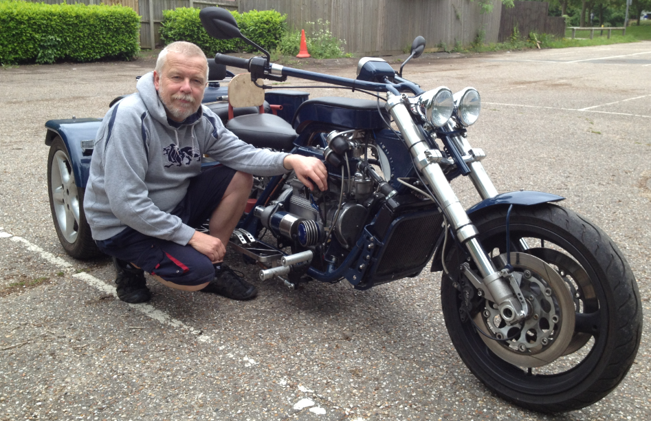

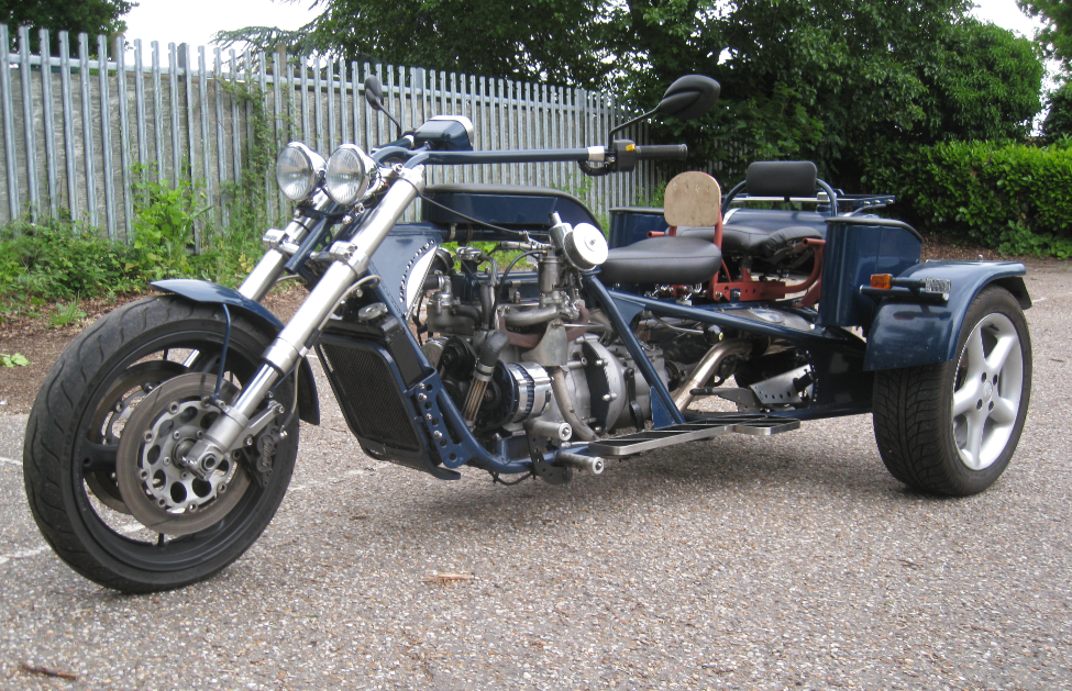

 The rest are just lil ole me!............
http://i956.photobucket.com/albums/ae49/HJody92/dd.png
RODS build........
http://i956.photobucket.com/albums/ae49/HJody92/DADD.png
RODS build........
http://i956.photobucket.com/albums/ae49/HJody92/DAD1-1.png
RODS build........

Thanks .
 Luke...the backrest has made a hell of a difference from comfort point of view.I attached the backrest pad so that it swivels horizontally so that it fits the angle of my back whether Im sitting upright or slouching down.From my experiments Ive found that it will only need minimal padding as it always stays flat to your back without creating a pressure point like the hoop type fixed backrests do.Tried mine with just the hoop and it caned one point on my back! The hoop also serves as a hold on point for the pillion,but SWMBO and everyone else who has sat or rode on the back all say it could do with a grab handle on each side ,hence why I put them on.(maybe better for your daughter to feel more secure?
 I realise ,of course ,you have to stop adding all these attachments,but I feel the tweaking stuff Ive added is worthwhile as Im hoping to cruise the hell out of this on the continent next year! and Ive tried to blend them in a bit with the theme. Hoping to get the whole lot of upholstery re done maybe early next year.

   Already have replaced the back pad in the pics^^^^^ with a larger horizontally swivelling type,much more comfortable apparently.Its sides that are needed to stop sideways movement,and also some sort of hand holds. The ones in the pics^^^^^^ Ive removed as they werent exactly aesthetic!They werent used anyway,as passengers seem to prefer to hold the uprights of the rear backrest ie hands down to their sides,and slightly back.This swmbo tells me is to brace herself if I brake suddenly and she goes forwards. To  help this ,Ive tilted the seat squab backward a fair bit,and brought it forward a bit .
 Im running the rear tyres at 18 psi,maybe too hard?
 Maybe I'll have a look at pics of Goldwing type rear seats.
« Last Edit: June 23, 2012, 07:02:39 PM by ROD » Logged
