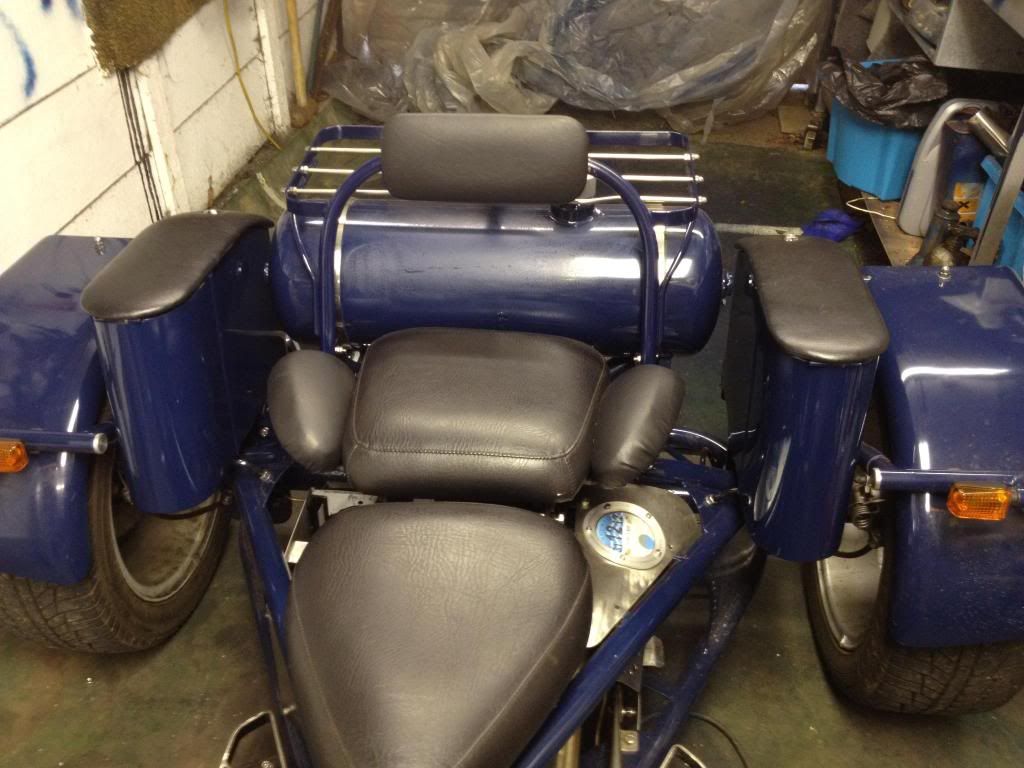

The trike rode well to Trikefest and back,no major probs. Cos Im running in the engine,kept to a steady 40/45 mph and a couple of blasts up to 50mph. The main problem arising from the journey (apart from the appalingly bumpy road between Mildenhall and Littleport! Grin)was the rear seat space( depth). I found myself moving too far forward on the front seat to accomodate, as we went over bumps SWMBO tended to move/slip forward on the seat . I think it needs some work. So Ive removed the rear seat , tank and rack,and re mounted the tank about 3" further to the rear. The seat and rack will all move the same amount backward,this should give more room to the rear passenger,and I'll also tilt the seat squab a bit lower at the rear.  Im also going to build 2 small arm rests either side ,and make them height adjustable. The wider gap between the front/rear seats will accomodate a upside down 'U' shape for a front seat backrest/come grab rail for the passenger,with a built in storage area. Im going to make this adjustable to be able to tilt it slightly back and forth to get the best position for me ,as well as the pillion passenger.
  Another problem that was evident was the 'floorboards' ,they need to be wider for the passenger,so this week I'll extend them and get them TIG'd together.Trying to get all this done by the end of the week,cos if the weather holds we may have a couple of days meandering round the Kent or Essex coast.

Down to the fine adjustments now then Rod. I once saw a car seat headrest used as a trike backrest -height adjustable, weather proof, (it was one of those rigid plastic ones with the open centre, maybe Metro), & suprisingly comfortable.

Head rest is a good idea,but not enuf room.Now maybe if I.....then I .........NO NO NO! Grin
 Got to get all refinements sorted or else"they" wont come out with me!
 Re doing this rear end is like going back to the build stages...but this time I know when its done I can just flick that switch and ride it!
