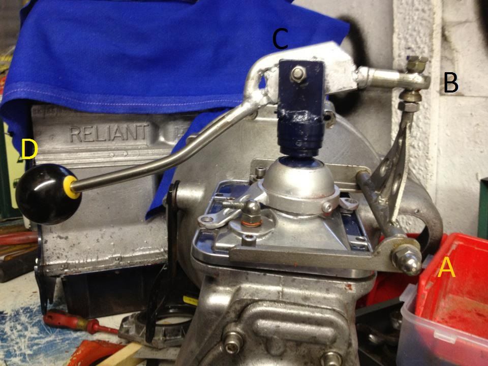

Cant do much today,so thought I would do a detail of my shifter,which may be of help to someone.so here it is courtesy of Jodys comp wizardry........

RODS build........
 A TO B = 3 7/8"
 B TO C = 3"
 C TO D= 10"
 I tapered the top of some 8mm nuts to allow the rod end to travel as far as I dare.(joint B)
 Pivot at A has bronze bushes. to accept 8mm bar that runs through a piece of tube that fits losely over the bar.
 the 'pin' pivot at C is a piece of 6mm stainless rod threaded both ends.
 I found the orig. g/lever was slightly bent as it came out of the ball and cup,so I straightened as best I could,then brazed a sleeve over,(about 1" long) it to up the diam.and straighten it .
 Then I machined a lump of bar to accept a bronze bush that fits the g/lever stub.
 I drilled the end of the g/lever to accept a 5mm(I think) bolt,which sits in the base of the fork at C. This allows the 'fork' to rotate ,but not come off the g/lever stub.
 the g/lever is mounted on a lump of 1/2" block,that is a tight fit into the fork.
 I had to juggle the g/lever length and the way it is fixed to this block so that it clears my frame.
 I did find that there was a lot of strain on the spring clip holding the ball/cup in ,hence I built the stronger mounting for it.
 Most of the components are as I first did them for the prototype. It worked so well firsttime,that I just beefed everything up with weld etc,so some of it doesnt look too fancy!In the rides Ive had so far it has been very positive gearchanging. I've got another orig g/lever that Im going to modify into a basic dogleg,as a quick replacement just in case this one breaks1

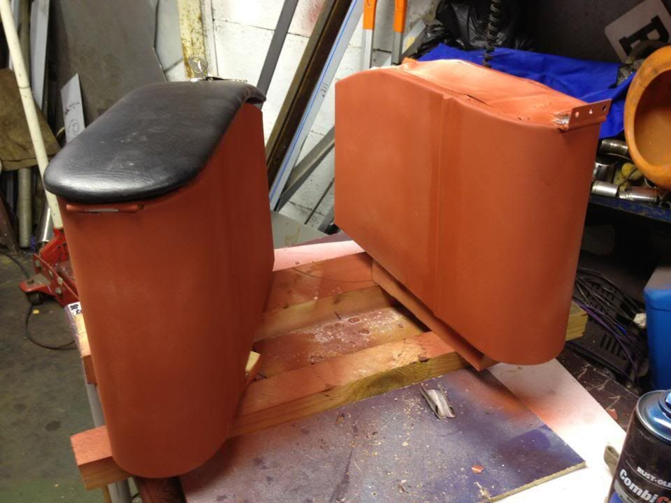

 Ive been builing these panniers out of aly etc. The padded lid is just sitting on top for effect.

« Reply #729 on: April 15, 2012, 05:30:33 PM »
So does the gearchange take the sloppiness out? I've got a similar shaped gearstick on my trike build, but because it's on it's side it gives an odd change pattern & there's lots of travel across the box from 2nd to 3rd.
Panniers look much nicer than a plain square box.

Theres definitely no slopiness . The change pattern is the same as usual,but TBH I havent give the distance between gears a thought! It was very easy to get used to ,and second nature now.
 The panniers took many hours to make,as there are so many processes involved.As with all botchers shed builders,I can see the faults,and ideally would like to make another set!
