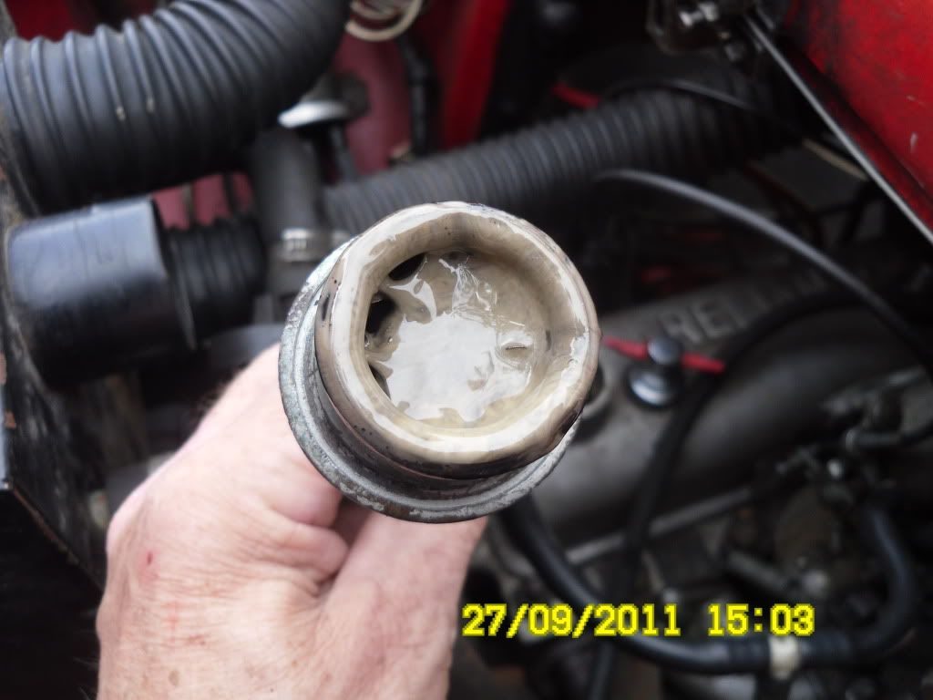

I would say that it is 99 % certain that the head gasket has gone  Sad
If your rocker cover breather cap looks like
Click on photo to enlarge
http://i1251.photobucket.com/albums/hh543/fifermanky/CYLINDER%20HEAD%20STUFF/ROCKERCOVERGUNGEINFILLERCAP.jpg
RODS build........
Then a good chance that the head gasket has gone { Note though that you can get mild examples of that through the engine not being used for a long time and /or very short journeys }

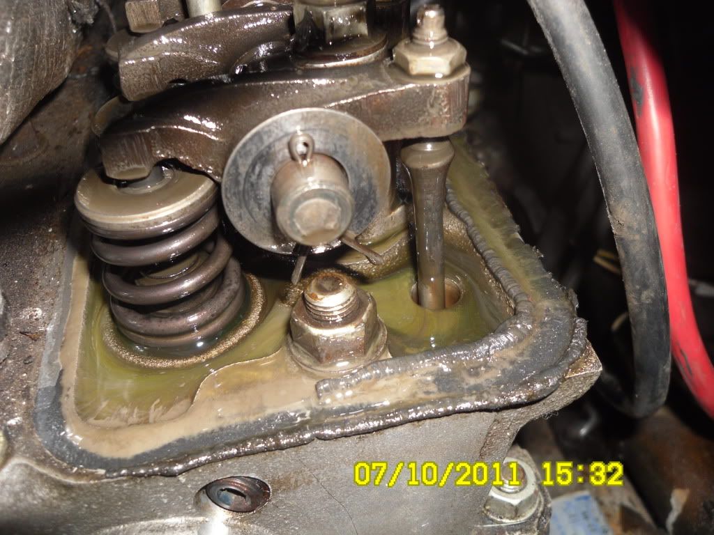

But if when you remove the rocker cover you have the following , then it probably has gone to the great bust head gasket home in the sky
http://i1251.photobucket.com/albums/hh543/fifermanky/CYLINDER%20HEAD%20STUFF/ROCKERCOVERGUNGEINALLOYROCKERCOVER.jpg
RODS build........
http://i1251.photobucket.com/albums/hh543/fifermanky/CYLINDER%20HEAD%20STUFF/CYLINDERHEADGUNGEANDEXCESSRUBBERSOLUTIONFROMALLOYROCKERCOVERFITMENT.jpg
RODS build........

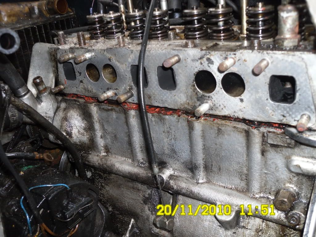

Note the black rubber sealant left by a previous owner using it to seal the rocker cover ; All you need is grease .
A warning sign of a poor previous head gasket change is any RED or Blue  stuff around the cylinder head join . You do not need to use any sealant whatsoever
Click on photos to enlarge

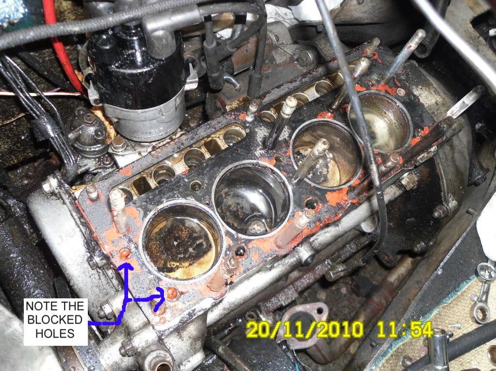

http://i1251.photobucket.com/albums/hh543/fifermanky/CYLINDER%20HEAD%20STUFF/CYLINDERHEAD1996SHOWINGREDCRAP.jpg
RODS build........
because the following is what you will end up with
http://i1251.photobucket.com/albums/hh543/fifermanky/CYLINDER%20HEAD%20STUFF/CYLINDERHEAD1996SHOWINGBLOCKEDCHANNELSDUETOUSEOFREDCRAP.jpg
RODS build........
