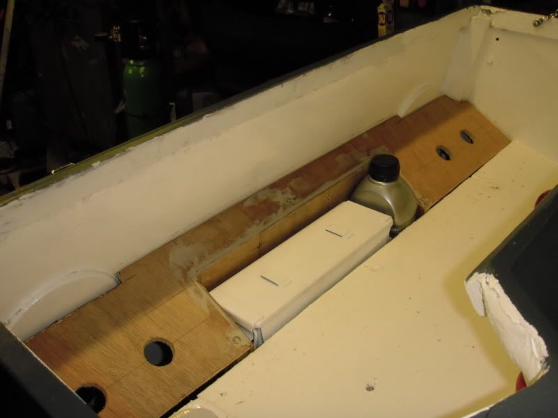

spent some time looking into the shovelhead and why its not running so a little slow on this the last few weeks. only thing that you can see moving forwards is the inside of the box. just been tidying up loose ends and little bits and pieces that take for ever near the end of a project. bits of wiring, odd little brackets here and there, seat mount etc.
i made an insert for the box that covers the backs of the lights so i dont smash them off with my tent etc. and it has a nice little compartment for a bottle of oil and a tool kit

« Reply #113 on: October 12, 2009, 10:14:58 AM »
Detailing makes all the difference to any build doesn't it. Lookin' good my man.

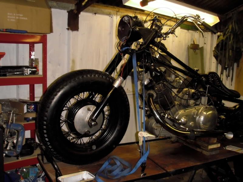

well - got the proper front wheel in there now with the front anchor made to accept 2 cables so i can run my handbrake there aswell, and yes -  i know - the build looks to be going backwards but the outside shot was just a prop together to
a] give me a kick in the arse to get on with it and
b] make sure i liked it on the floor

« Reply #118 on: October 26, 2009, 12:41:32 PM »
nope it definately pointing forward  Tongue
