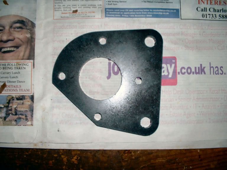

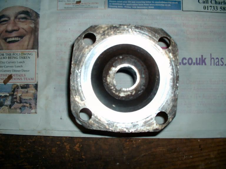

Evening , nice one  ...  clear and easy to follow and with piccies  Grin ( I do like a piccie ) ....  I've used the small holes and jig sawed ( or waggled the drill bit about to open out the holes ) method  on wood and thin plate ,  never thought about doing it on 6mm plate though  ..... looks good .
I got my plates and hubs back on monday .....  ,  took about 5 weeks to get them back  Shocked  , seems everywhere they went as soon as they said it was for a trike nobody wanted to do them  ...  something about liability for automotive parts ( thats what they told me anyway , and before you ask I dont want to buy tower bridge  ...  I already bought that last week    Cheesy ) , they said they told the last guy that the bits were from a french conveyer system  ..   Grin

« Reply #13 on: November 27, 2008, 09:12:04 PM »
One more conversion done by the weekend then  Grin.
Looks like your going for the thicker wheel studs too?
