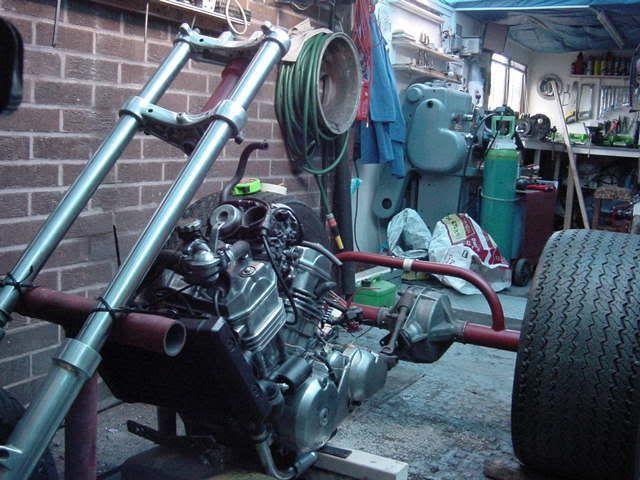

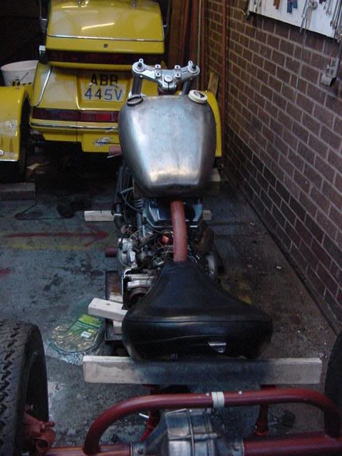

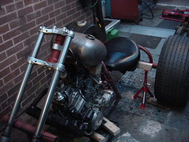

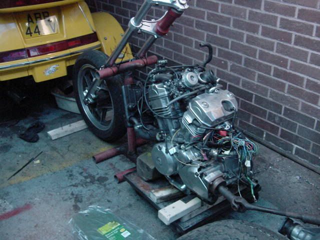

Ive been busy today trying all the bits out and mocking up the trike today
mouse's new trike project :-)
what do ya think ?

I like that! The tank looks nicely in proportion with the engine, nice comfy single seat and a fat back end, perfect!
Looks as though there's gonna be some nice trikes about this year.

Looking very good there Mr Mouse. Very long forks. What are they from? Maybe lower the headstock a little? Based on my experience with the first one I built
Sharon's XS750
I'd say keep the centre of gravity as low as you can & think about a fork brace.
Cool lookin' ride though

sorry i struggled to get the shot i have
thanks for your comments
Andy you say to lower the headstock
can you elaborate on this please
the forks are Kawasaki gpz900 bottoms with kwak Klr 600 tubes and and guzzi headstock
Mousy Boy :-) AKA Mick
Re: mouse's new trike project :-)
Reply #59 on:
February 06, 2008, 07:04:31 PM »
great looking stuff Mouse,think manky meant was lower the headstock"front end" till the headstock is about 8 inches above"roughly" the heads of the motor
making the front lower and overall length longer
