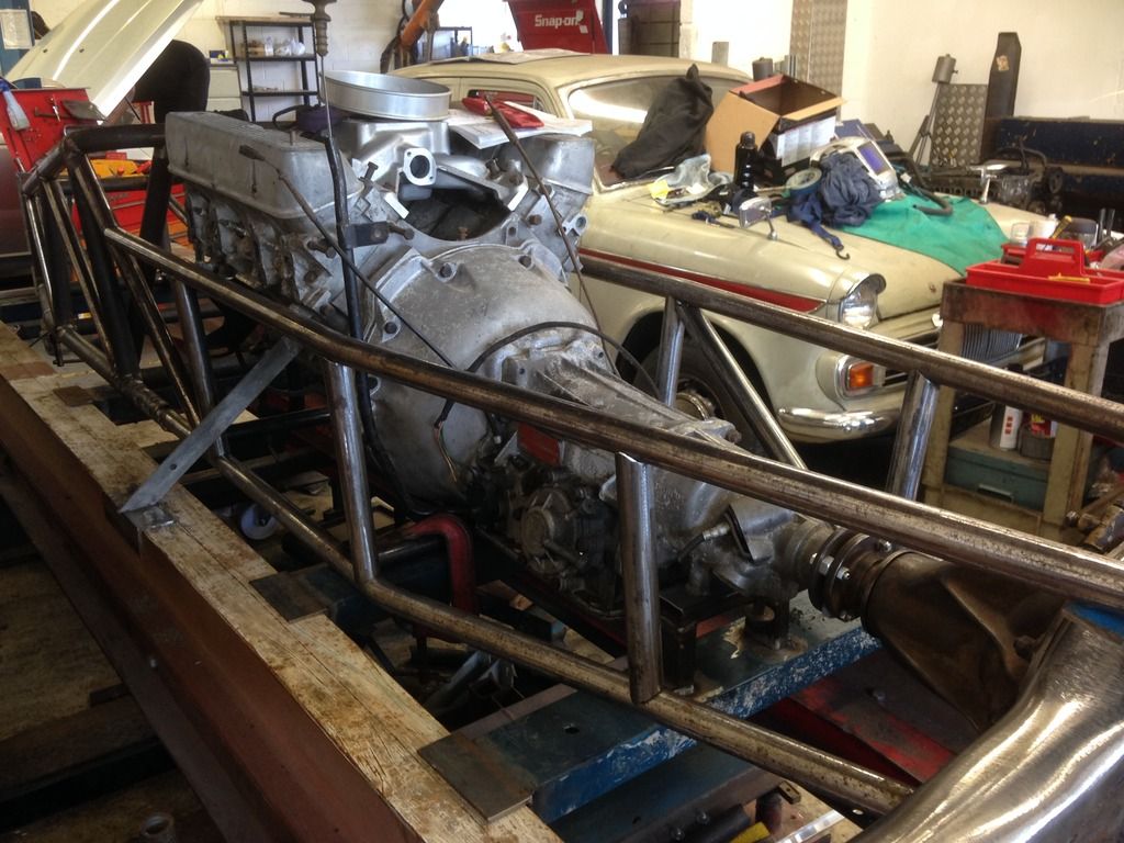

http://i1244.photobucket.com/albums/gg579/Kevin_Bingham/Bellytank%20Chassis/617_zpsqtqkww6u.jpg
D72 British Bellytank
And other side, here you can see the engine mounted to the jig and the rear axle supports. Loads of measuring and double checking to get them in position and then build the frame around them.

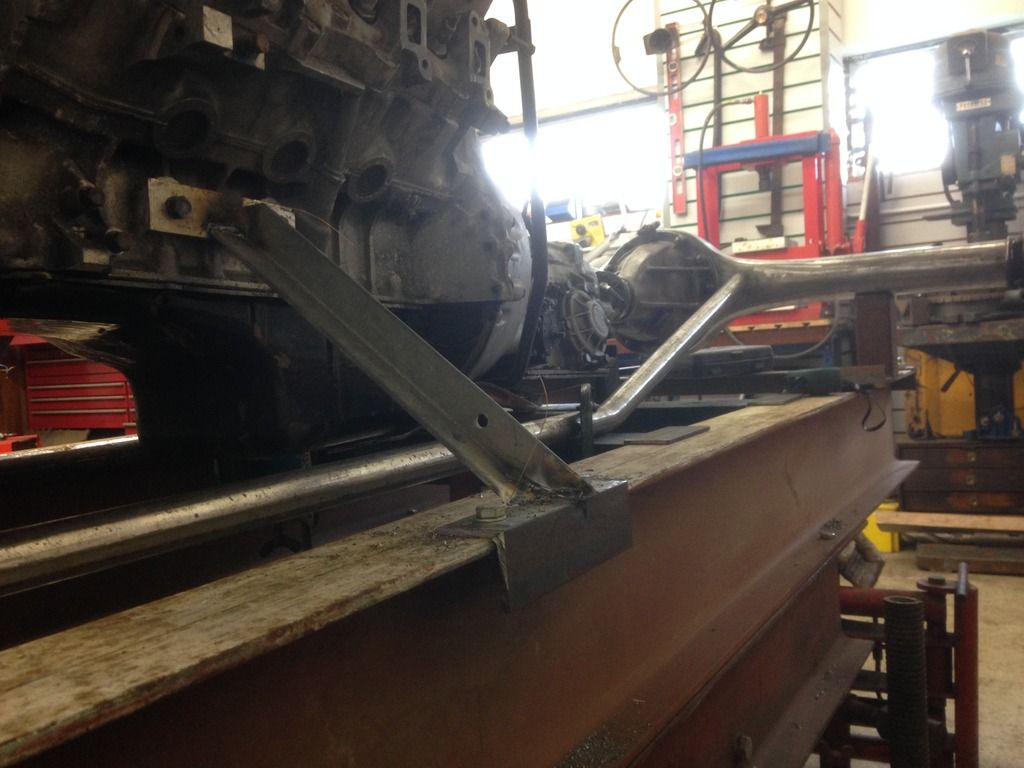

« Reply #46 on: October 16, 2016, 04:03:26 PM »

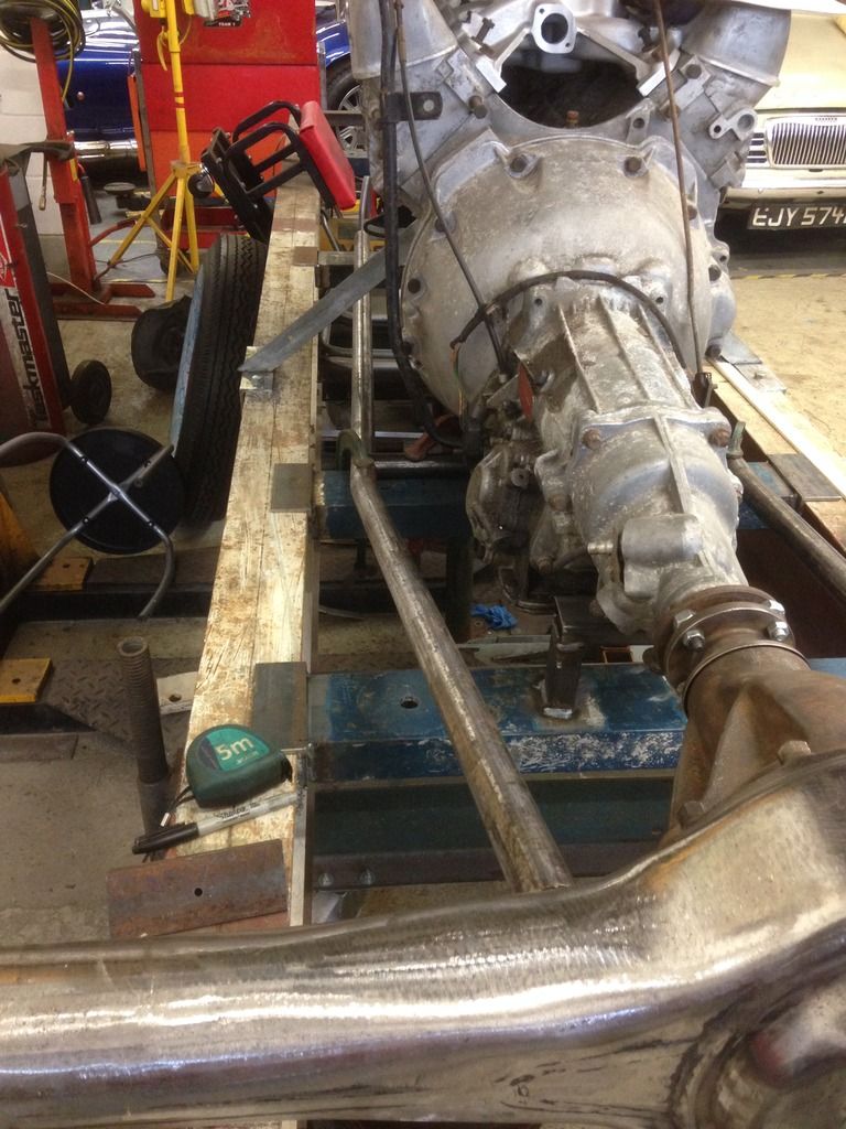

http://i1244.photobucket.com/albums/gg579/Kevin_Bingham/Bellytank%20Chassis/616_zpsdsedxz8d.jpg
Gearbox was also mounted to the chassis jig as seen here.

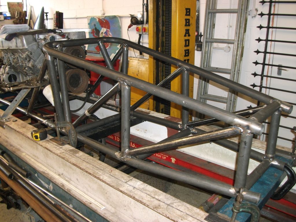

http://i1244.photobucket.com/albums/gg579/Kevin_Bingham/Bellytank%20Chassis/IMG_52132_zpsczzu4efz.jpg
Safety cell taking shape.
« Last Edit: February 12, 2017, 10:33:08 AM by TerryFwit » Logged

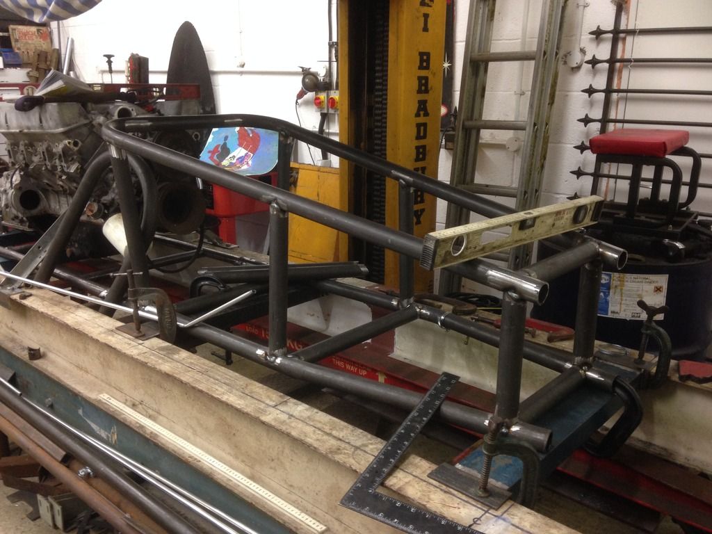

« Reply #48 on: October 16, 2016, 04:09:02 PM »

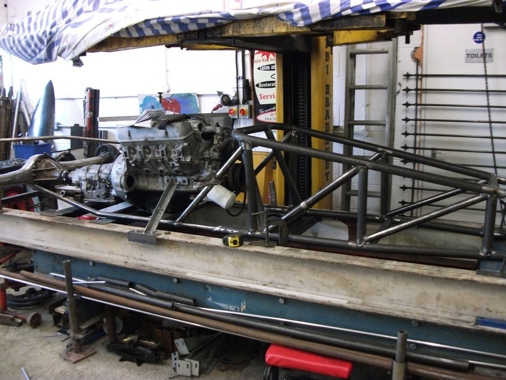

http://i1244.photobucket.com/albums/gg579/Kevin_Bingham/Bellytank%20Chassis/DSCF1447_zpsvqmkjhzr.jpg
A few braces and the rear tubes behind the seat in place.
« Last Edit: February 10, 2017, 10:09:58 PM by TerryFwit » Logged

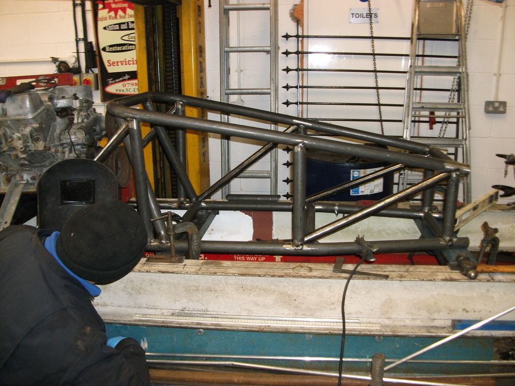

« Reply #51 on: October 16, 2016, 06:49:21 PM »
http://i1244.photobucket.com/albums/gg579/Kevin_Bingham/Bellytank%20Chassis/DSCF1449_zpscvernurd.jpg
Side view, tops of rear frame to do in the same style as front section.
« Last Edit: February 12, 2017, 10:34:20 AM by TerryFwit » Logged

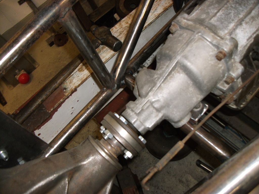

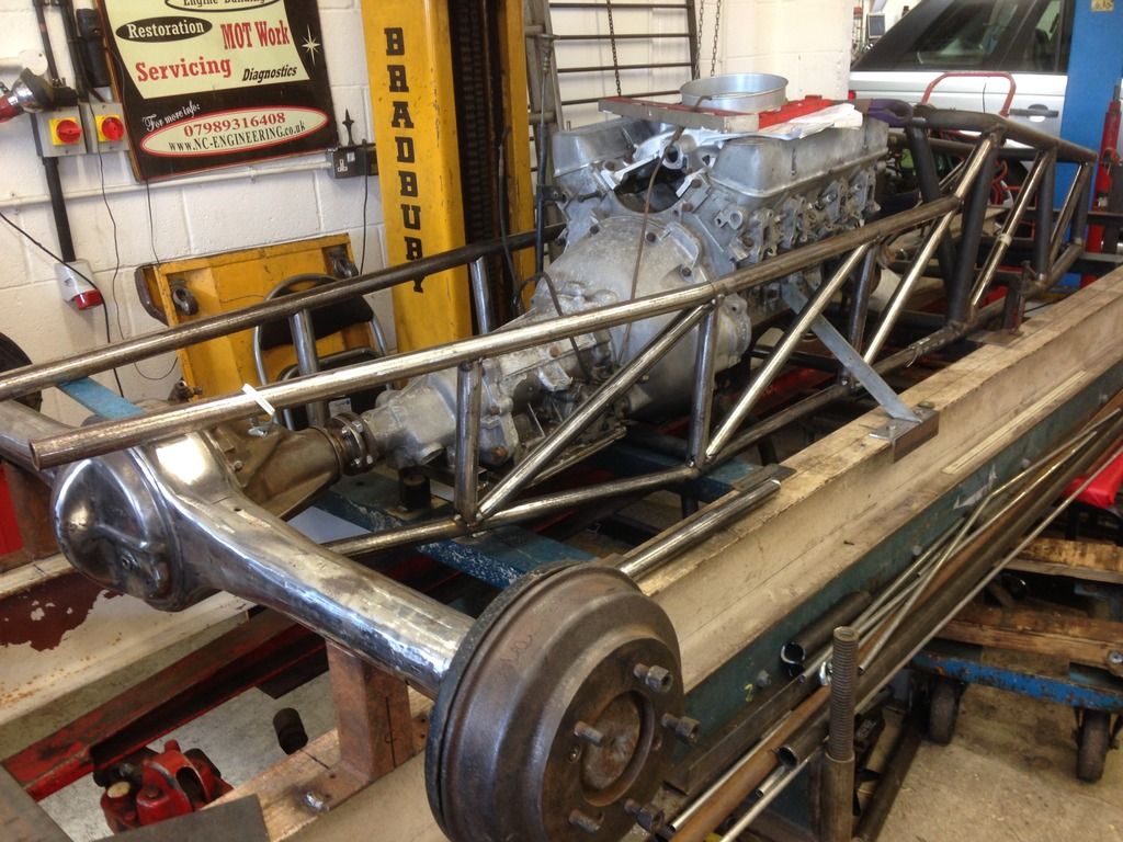

http://i1244.photobucket.com/albums/gg579/Kevin_Bingham/Bellytank%20Chassis/DSCF1497_zpsm37leywh.jpg
Machined up a spacer for gearbox and re-drilled input flange on gearbox to match the sherpa diff so every thing is aligned. Somehow this picture makes the temp bolts look wrong but it is perfectly true.
Now we can start with the engine, gearbox and axle mounts.
« Last Edit: February 10, 2017, 10:11:15 PM by TerryFwit » Logged

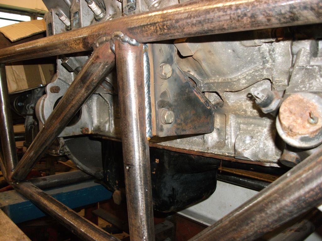

http://i1244.photobucket.com/albums/gg579/Kevin_Bingham/Bellytank%20Chassis/DSCF1488_zpsbdshsgto.jpg
Offside engine mount.

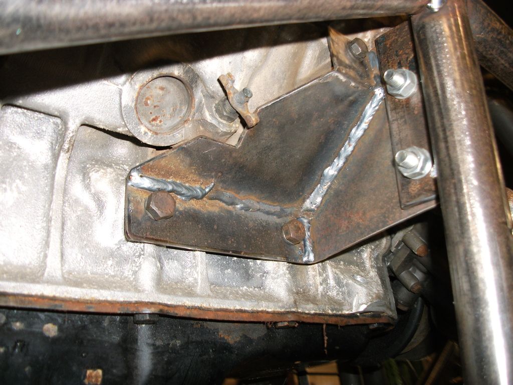

« Reply #57 on: October 18, 2016, 09:36:08 AM »
http://i1244.photobucket.com/albums/gg579/Kevin_Bingham/Bellytank%20Chassis/DSCF1496_zpstvi44dou.jpg
A bit rough at the moment but will be cleaned up before painting.
