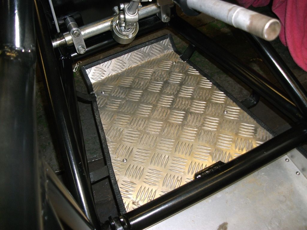

« Reply #260 on: February 17, 2017, 01:33:57 PM »
Had some edge trim left over so trimmed up the edges on the floor plate and fitted into chassis.
http://i1244.photobucket.com/albums/gg579/Kevin_Bingham/Bellytank%20Build/DSCF2352_zpslnxhhg0j.jpg
D72 British Bellytank
http://i1244.photobucket.com/albums/gg579/Kevin_Bingham/Bellytank%20Build/DSCF2353_zpshpofodw0.jpg

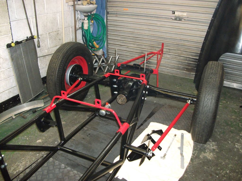

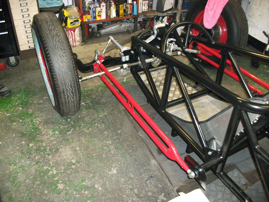

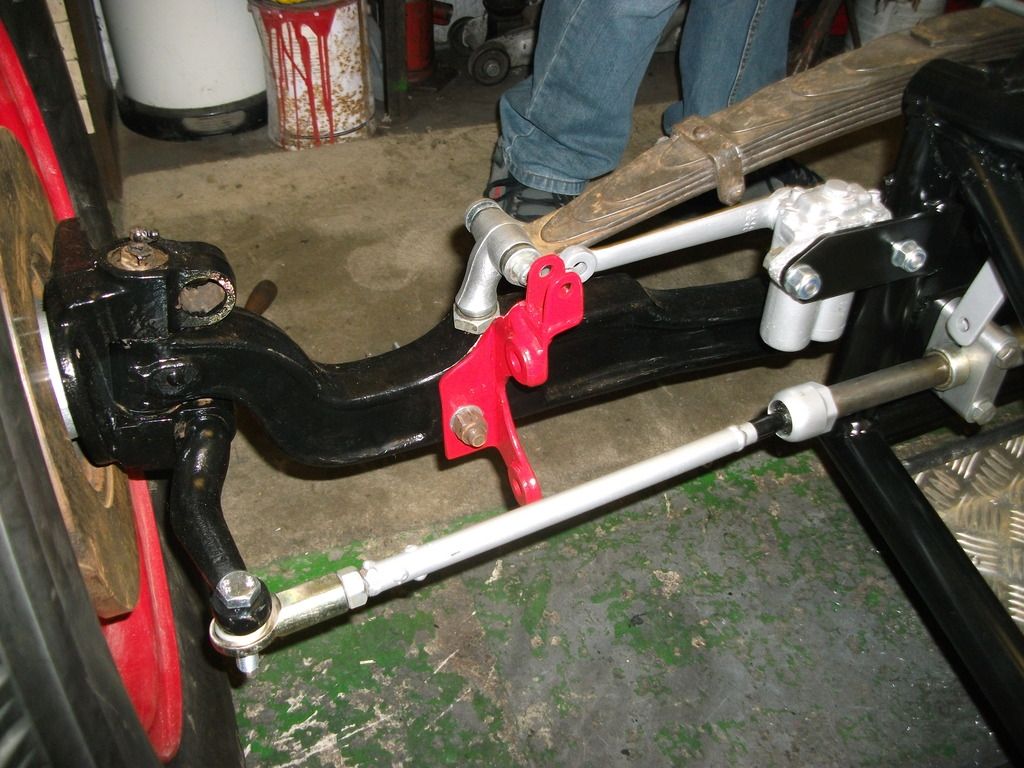

Also collected parts from the powder coaters.
http://i1244.photobucket.com/albums/gg579/Kevin_Bingham/Bellytank%20Build/DSCF2347_zpswdv6iedj.jpg
And bolted on the first piece.
http://i1244.photobucket.com/albums/gg579/Kevin_Bingham/Bellytank%20Build/DSCF2354_zpshjcfhjnu.jpg
And then got carried away and threw the rest on to see how it looks.
http://i1244.photobucket.com/albums/gg579/Kevin_Bingham/Bellytank%20Build/DSCF2355_zpsl0eugo3c.jpg
http://i1244.photobucket.com/albums/gg579/Kevin_Bingham/Bellytank%20Build/DSCF2358_zpsuerbx225.jpg
http://i1244.photobucket.com/albums/gg579/Kevin_Bingham/Bellytank%20Build/DSCF2361_zpsuf1imgcw.jpg
http://i1244.photobucket.com/albums/gg579/Kevin_Bingham/Bellytank%20Build/DSCF2362_zpsflaa6kpg.jpg

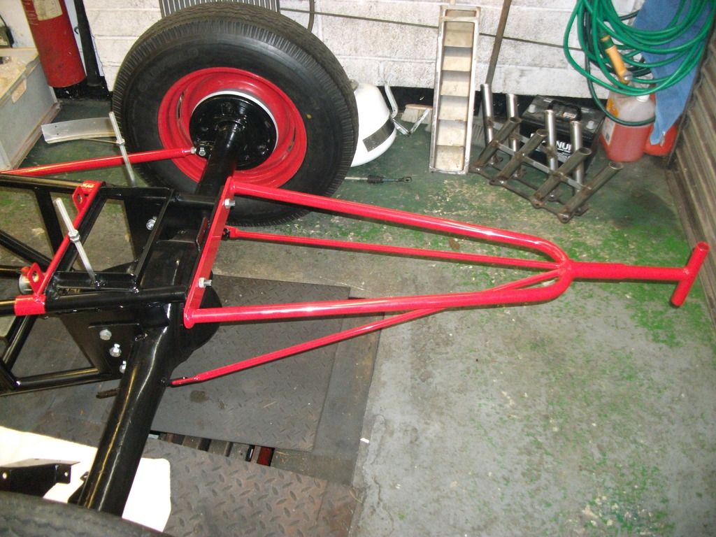

« Reply #262 on: February 17, 2017, 02:51:00 PM »
Once again sir, do have any bracing for the radius rods where they attach to the chassis ? Lots of stress in that area ? Wink looking good though ?
TerryFwit
Karma: 4
Posts: 280
« Reply #263 on: February 17, 2017, 03:32:46 PM »
Well spotted on the bracing, there is supposed to be a brace between the two out riggers, front to back. Has not been fitted yet as we still have the lower air intakes to fit on the body and did not want to have them in position until that was done. Was also going to put a plate below the front out rigger at the same time. The rear out riggers and arms are just for show really as the axle is solidly mounted.

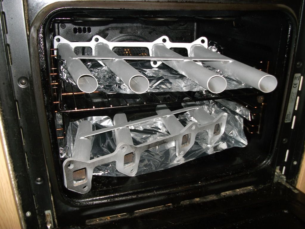

« Reply #264 on: February 19, 2017, 09:46:34 AM »
Made a lovely double rack of 'Headers' last night  Grin
http://i1244.photobucket.com/albums/gg579/Kevin_Bingham/Bellytank%20Odds/DSCF2363_zpsoxxe2wr6.jpg
« Reply #265 on: February 19, 2017, 12:32:33 PM »
Delicious!
stinkey
Karma: 93
Posts: 2757
« Reply #266 on: February 19, 2017, 07:43:00 PM »
What sort of temp would one cook these and do they taste good ?

« Reply #269 on: February 26, 2017, 03:08:31 PM »
Cheers, now braces and gussets. This will please someone Grin but  needed doing.
Outriggers needed a tube between them
