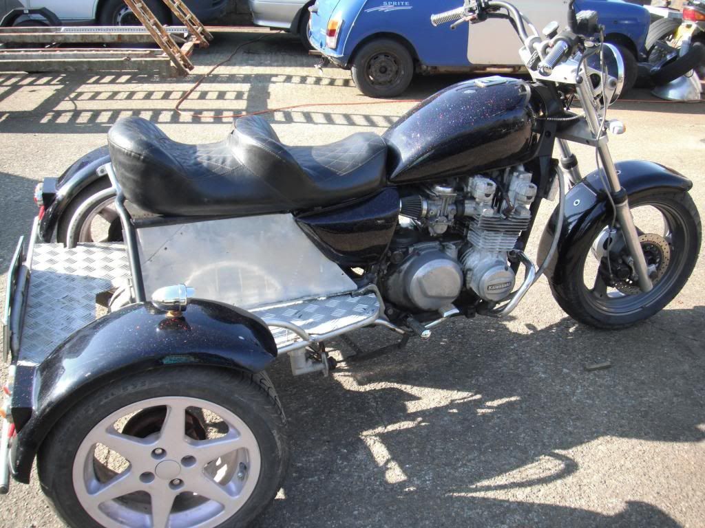

lets see, pic of trike, just a mockup for now, needs the offset axle etc fitting.
http://i65.photobucket.com/albums/h232/carreglasinimutly/trikeos_zps4bfece4f.jpg

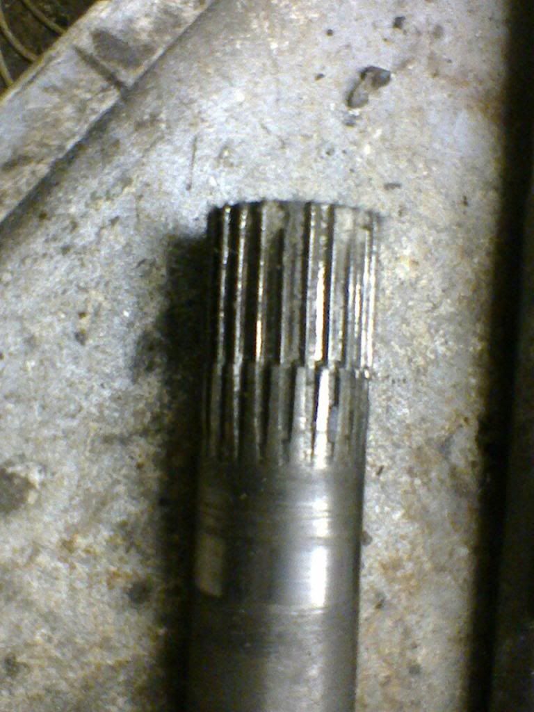

My knackered shaft end.
http://i65.photobucket.com/albums/h232/carreglasinimutly/splines_zps68a6e892.jpg

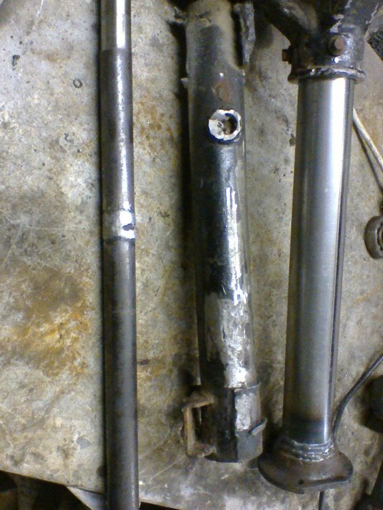

Old axle tubes next to one new one. I now have two, one long, one short -
http://i65.photobucket.com/albums/h232/carreglasinimutly/tubes_zps5407321b.jpg
