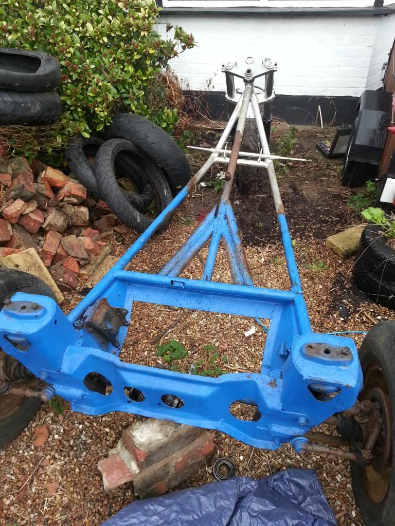

hey everyone I recently bought a frame of eBay and the seller recommended this site
This is what it looked like originally
http://i929.photobucket.com/albums/ad138/chris_dude1/20131013_162214_resized-1.jpg

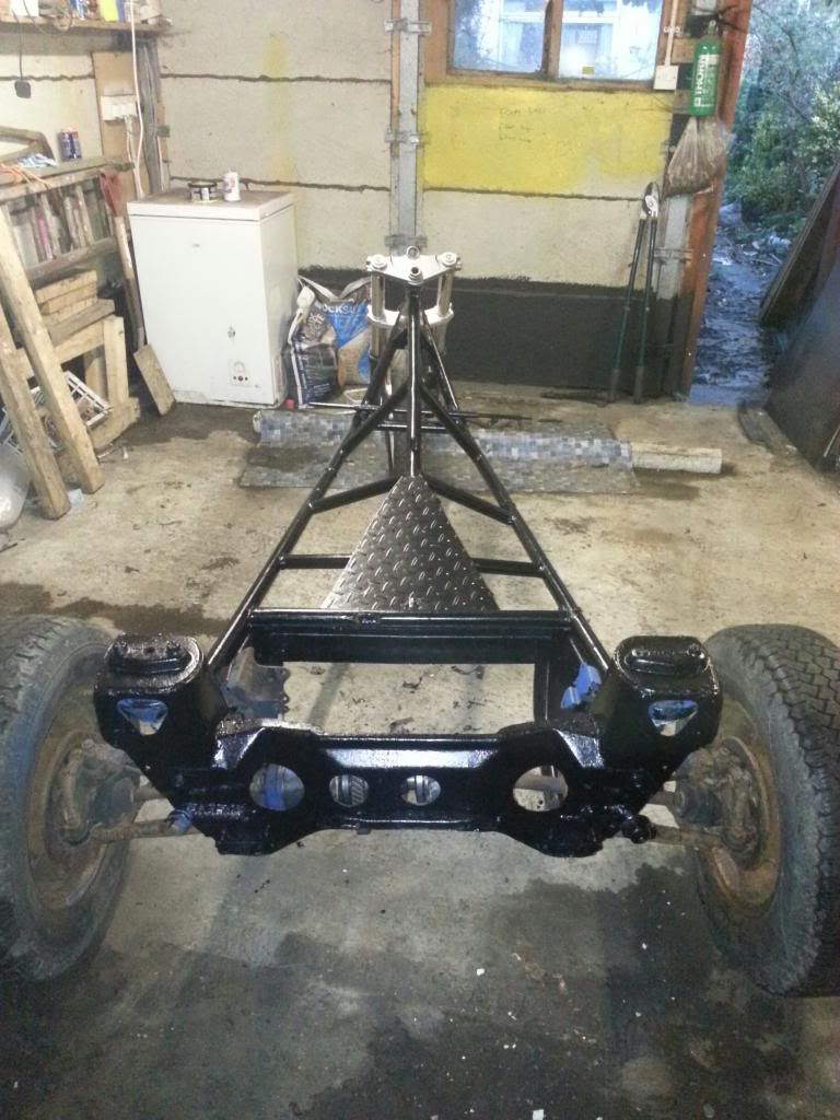

This is where Ive gotten to with the frame
http://i929.photobucket.com/albums/ad138/chris_dude1/20131109_161041_resized.jpg

im currently working on stripping and rebuilding a 998cc A series engine

Unusual frame. Be nice to see this progress.
« Reply #2 on: November 25, 2013, 10:21:46 PM »
Hi and welcome
I take it the trike is metro/mini based not seen many like that lately

Welcome Chris. The extra triangulation looks worthwhile. Looking forward to seeing this develop.

before adding the extra pipework there was a fair bit of flex in the frame now its solid no flex at all even with me and my mate jumping on it
I also added the plates to either side of the neck tube and the big plate to the bit at the centre where there are a lot of tubes joining
