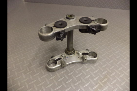

My BMW k100 motorbike i had, had brake pipes through the headstock using a tubular set up
http://i1061.photobucket.com/albums/t466/steveatthemorgue/reliant%20trike/null_zps8b3f8333.png
Brake pipe inside handlebars ?
http://i1061.photobucket.com/albums/t466/steveatthemorgue/reliant%20trike/null_zpsea6b4f4b.png

It was hollow, you see the tube that the branded lines connected to it fed through the tube
