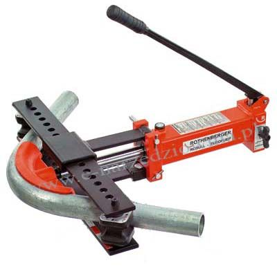

My 11/2 tube bent ok on my robull, the formers are quite deep 1" tube is extremely strong I guess you are looking for the chunky look or is this a back bone you are looking at ?
