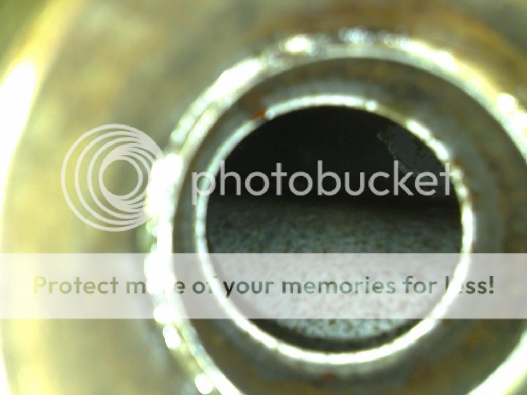

With lack of use during the last few winters and sweating of the tank this is the condition inside
http://i509.photobucket.com/albums/s336/dr-big750/Bikes/180320131134_zpse08da790.jpg

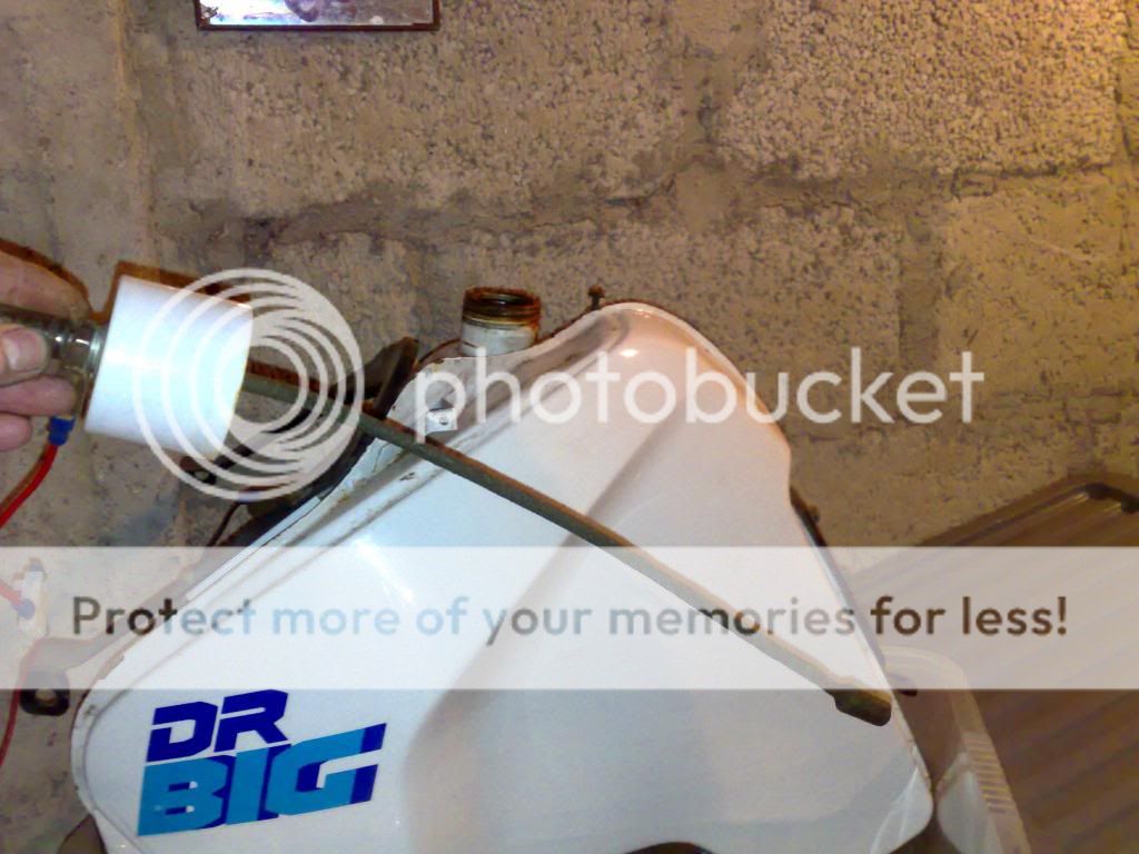

Used a bit of 8mm threaded for the anode rod as it was available with a piece of rubber on the end to stop it shorting out
http://i509.photobucket.com/albums/s336/dr-big750/Bikes/180320131135_zps63021c72.jpg
rusty tanks

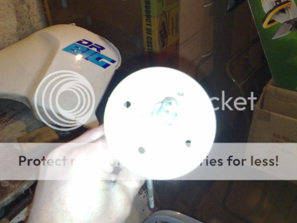

A few holes to allow the hydrogen gas to escape
http://i509.photobucket.com/albums/s336/dr-big750/Bikes/180320131136_zps2e24fae0.jpg
rusty tanks

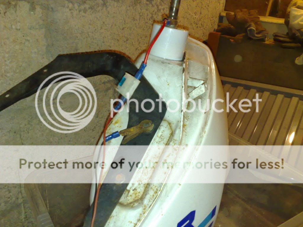

Wired up the battery charger, positive to the anode and negative to the tank
http://i509.photobucket.com/albums/s336/dr-big750/Bikes/180320131137_zpse5152529.jpg
rusty tanks
http://i509.photobucket.com/albums/s336/dr-big750/Bikes/180320131138_zps63754785.jpg
rusty tanks

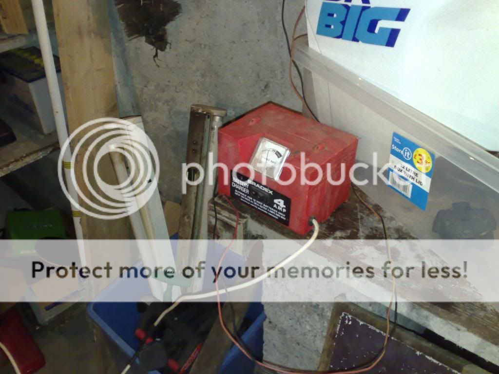

The battery charger was supplying about 2 amps to the process
http://i509.photobucket.com/albums/s336/dr-big750/Bikes/180320131140_zps83af566e.jpg
rusty tanks

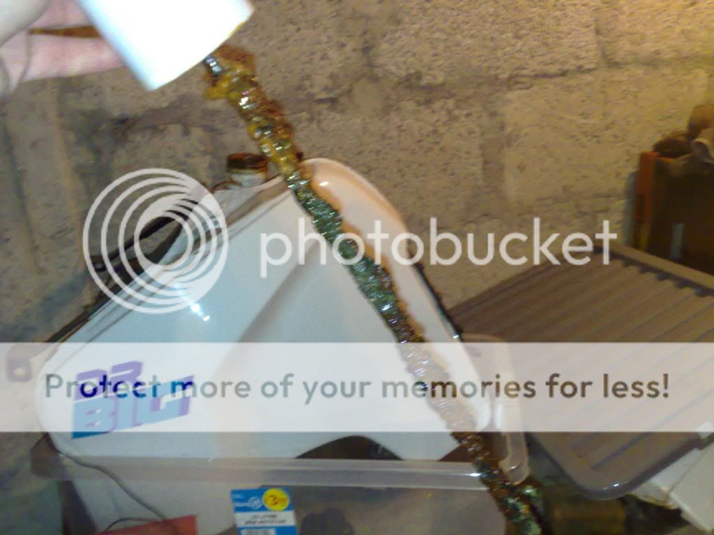

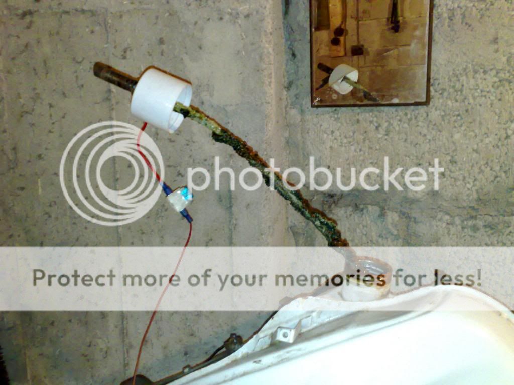

So let this do it's thing and the next day the 8mm rod looked like this
http://i509.photobucket.com/albums/s336/dr-big750/Bikes/190320131161_zps9f29230e.jpg
rusty tanks
Cleaned it and put it back in
After 3 days the rod looked like this, seems to be collecting something
rusty tanks
Cleaned the rod again and put it back in
http://i509.photobucket.com/albums/s336/dr-big750/Bikes/210320131163_zpse086888e.jpg
rusty tanks
After 5 days the rod had collected rust to look like this
http://i509.photobucket.com/albums/s336/dr-big750/Bikes/230320131164_zps0bda4ad1.jpg
rusty tanks
After a week I emptied the solution out and filtered it into the second tank, to start on it
After washing the crude and remainder of the loose rust and gunge this is how it looked
http://i509.photobucket.com/albums/s336/dr-big750/Bikes/230320131167_zps5a50d0cb.jpg
rusty tanks

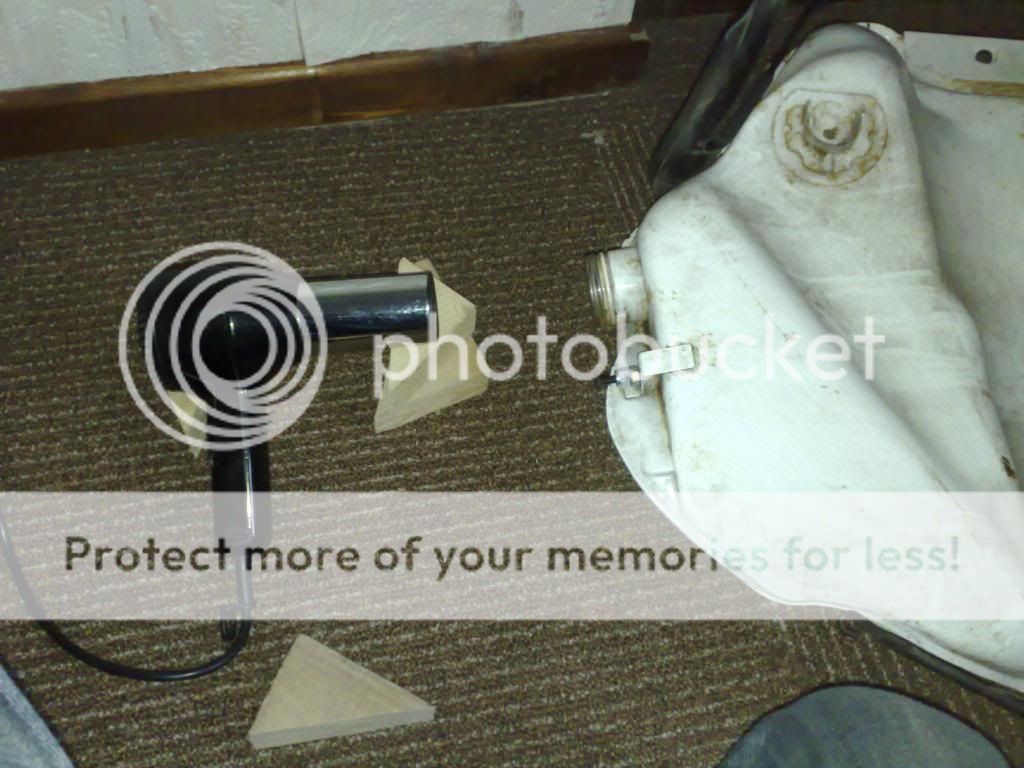

Not perfect but clean enough to not give any bother, so it needed to be dried pretty quick before it began to rust again
http://i509.photobucket.com/albums/s336/dr-big750/Bikes/230320131169_zps837c4194.jpg
rusty tanks
Finally found a dual use for her indoors hair dryer, When fully dry I'll wash out with diesel and then with diesel and some engine oil mixed and leave this in it until ready to fit to the bike
