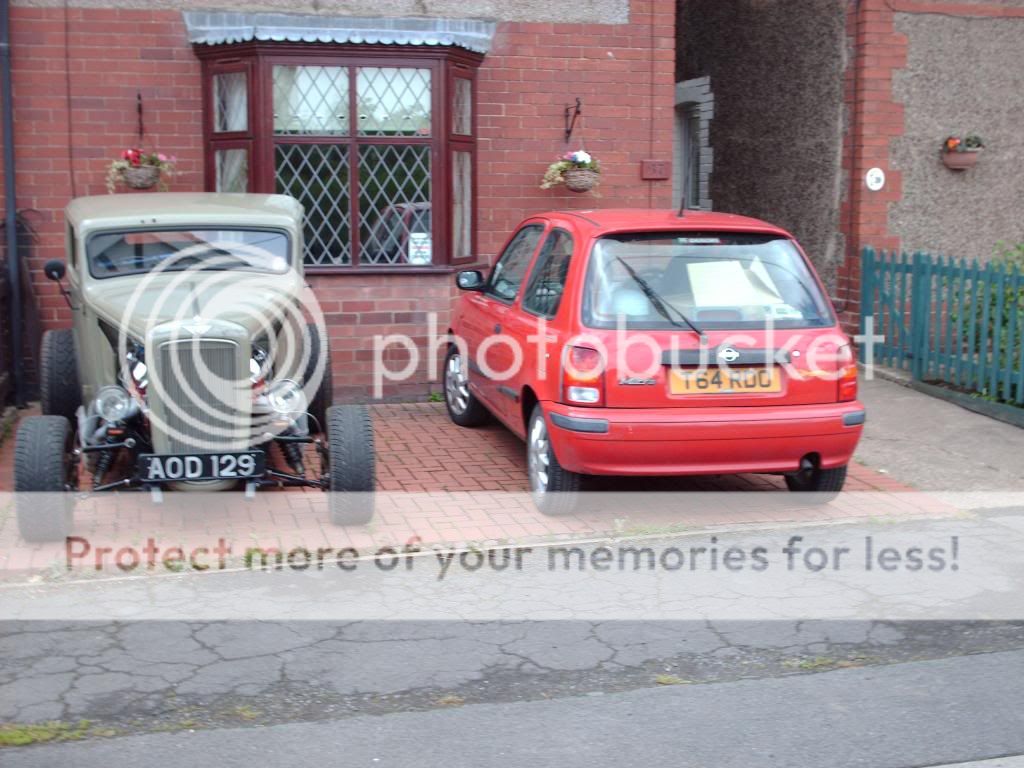

« Reply #555 on: June 15, 2013, 07:45:47 AM »
http://i468.photobucket.com/albums/rr41/spanners1964/emilytoday001_zpscd5fbc93.jpg
,,EMILY,,
but which does smokey burnouts?
« Last Edit: June 15, 2013, 07:47:49 AM by triker_Chewie » Logged
« Reply #556 on: June 15, 2013, 01:37:26 PM »
I hadn't realised just how petite she was! About the same size as a Moggy Minor pick-up?
