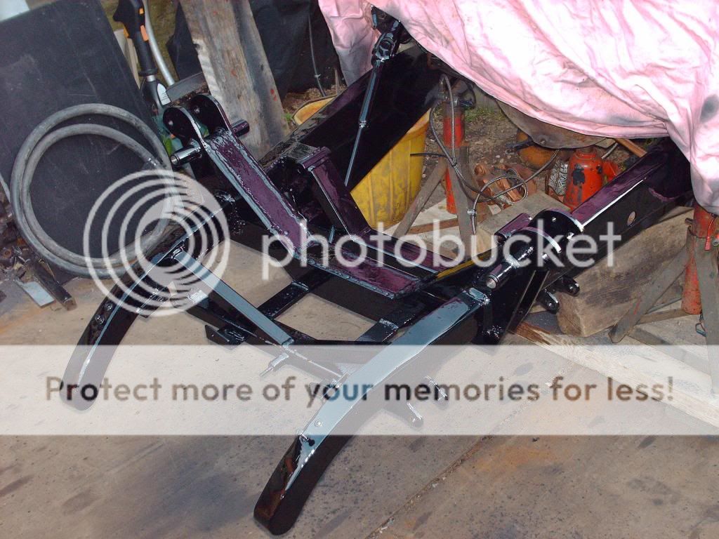

http://i468.photobucket.com/albums/rr41/spanners1964/crossmember001_zps319b4688.jpg
,,EMILY,,

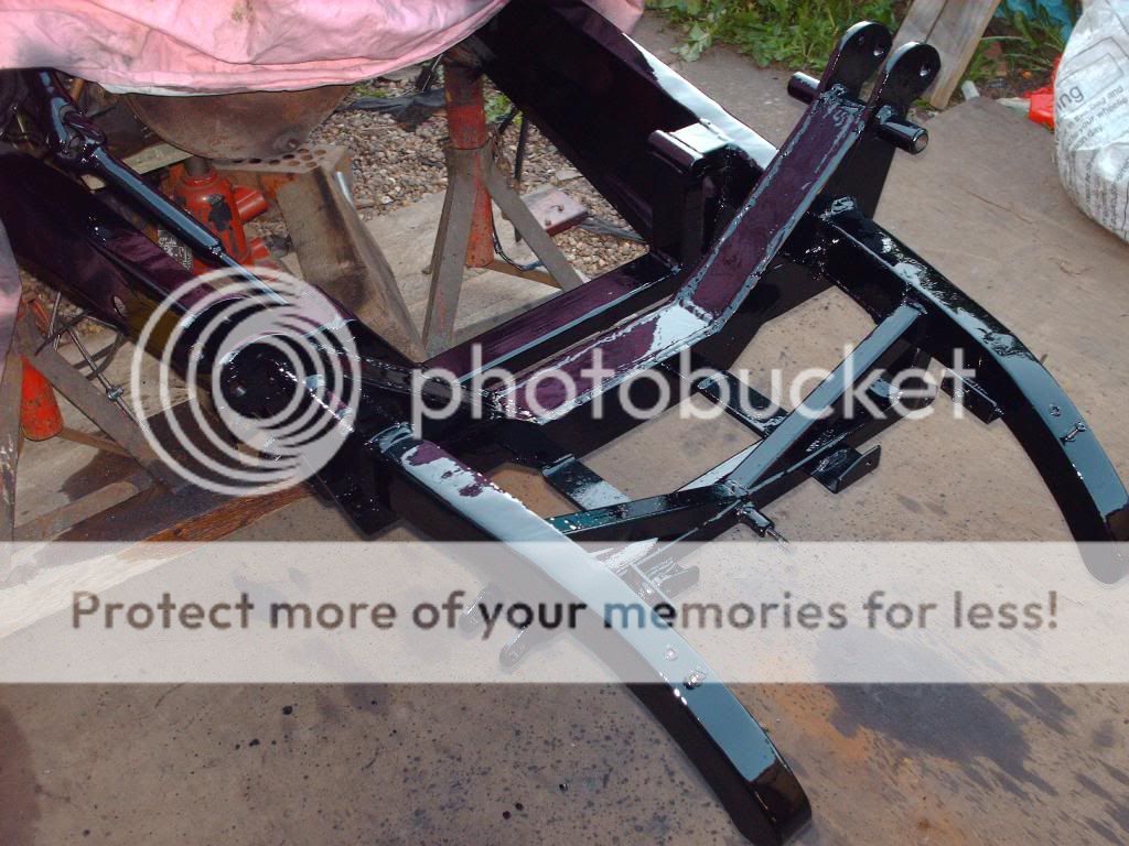

http://i468.photobucket.com/albums/rr41/spanners1964/crossmember002_zpsde7ed001.jpg
,,EMILY,,

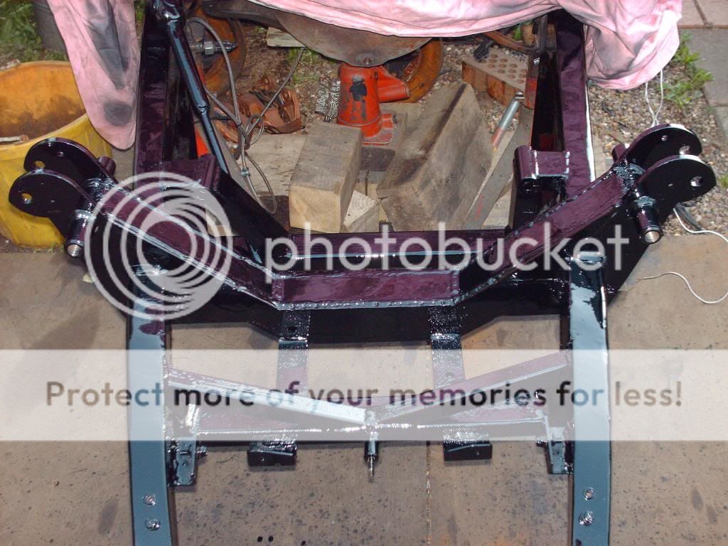

http://i468.photobucket.com/albums/rr41/spanners1964/crossmember003_zps3a9b9d02.jpg
,,EMILY,,
« Reply #494 on: June 02, 2013, 08:35:20 PM »
Looking much stronger. Smiley
Surprised there was nothing tying the two together before.
