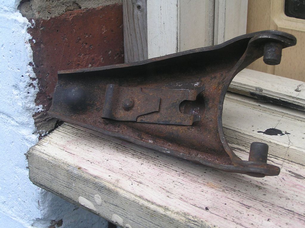

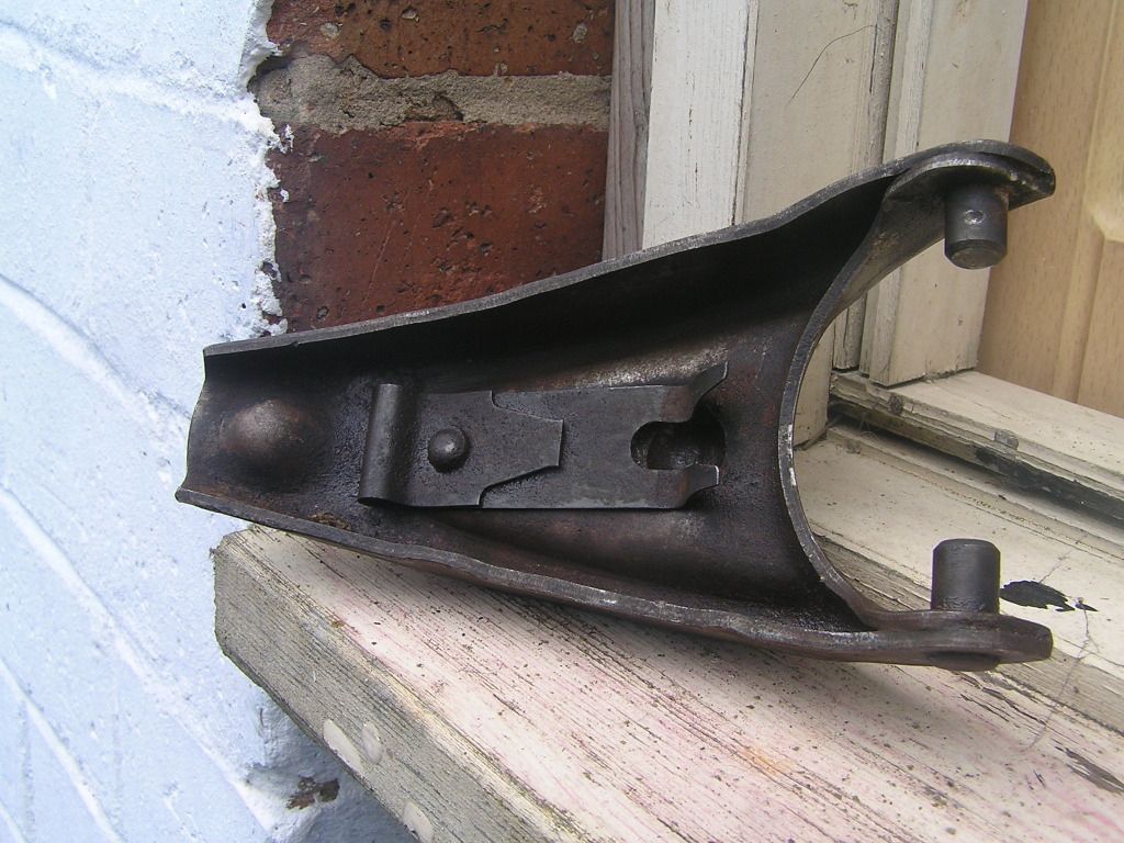

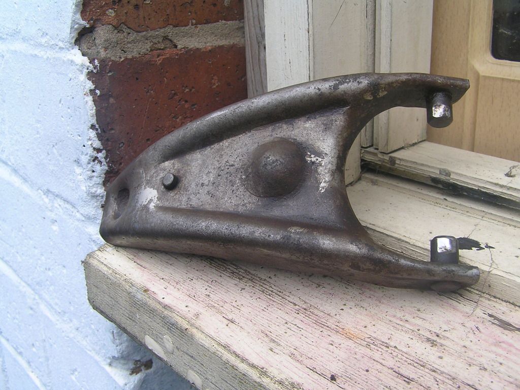

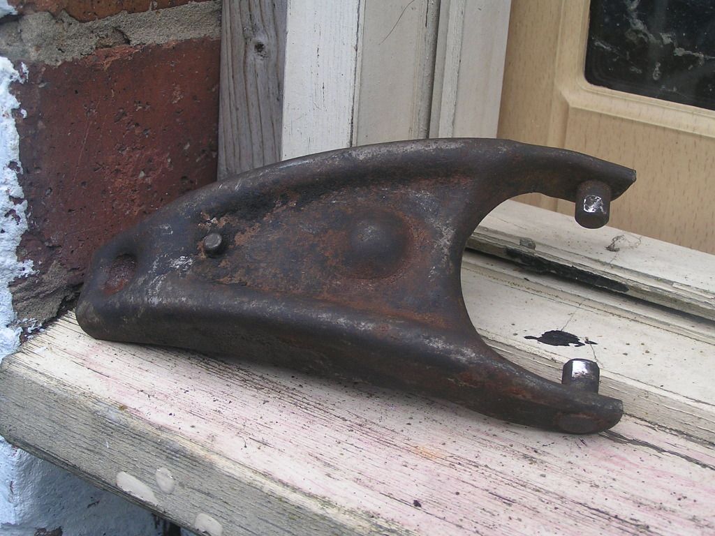

Before and after .. About half an hour with the charger method. that black stuff is like a softish carbon sort of stuff  scrapes off with your nail. If you clean stuff off and give it another go it comes out cleaner each time, oil old paint etc holds back the proses some what.
http://i174.photobucket.com/albums/w91/tikka25/Picture900.jpg
Rust removal
http://i174.photobucket.com/albums/w91/tikka25/Picture899.jpg
Rust removal
http://i174.photobucket.com/albums/w91/tikka25/Picture901.jpg
Rust removal
http://i174.photobucket.com/albums/w91/tikka25/Picture902.jpg
Rust removal
« Reply #10 on: August 01, 2012, 06:21:23 PM »
That's quite impressive. Looks as effective as wire brushing & certainly a lot less effort.

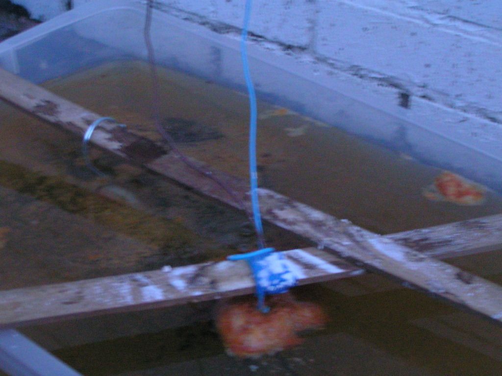

Got the malasses rust removing up and going last night, found this an old drill stand looked ok for tests, and some other bits and bobs added to the mix latter. Three guesses what it mixed in . Grin Grin
Long wait now though a week or even three.perhaps. Smiley
http://i174.photobucket.com/albums/w91/tikka25/rrr.jpg
Rust removal
