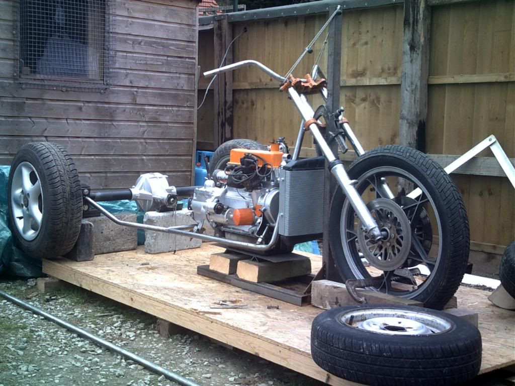

« Reply #15 on: May 30, 2012, 08:36:18 PM »
I just like them as simple as possible. Sometimes referred to as chopper styled.
Muffin's frame before it was powder-coated.

« Reply #16 on: May 30, 2012, 08:40:56 PM »
Very nice andy

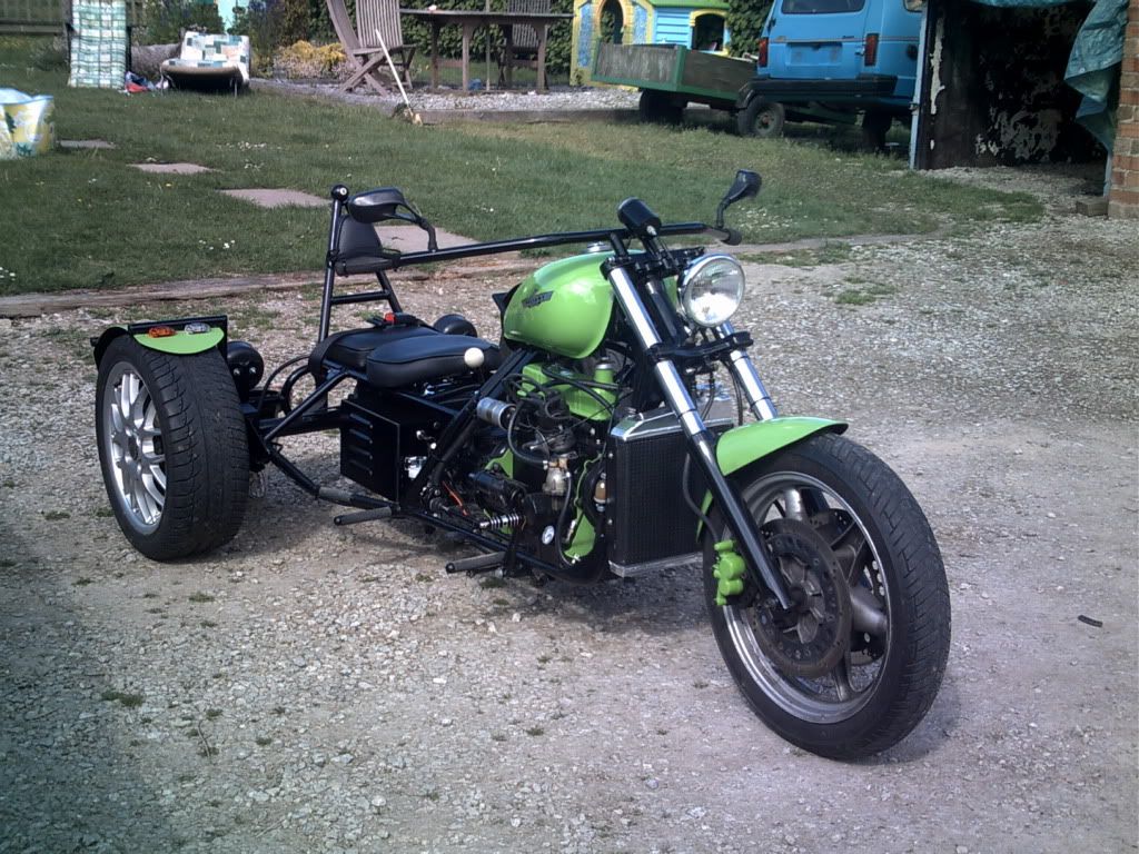

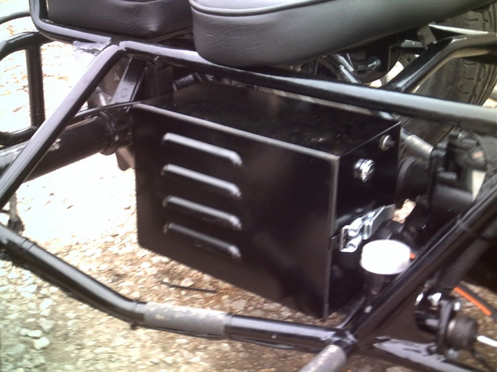

« Reply #17 on: May 30, 2012, 08:45:11 PM »
You can see the starter motor cover, made from a section of 2" tube, built into the far side of the frame. It covers the exposed pinnion gear as Mr Muffin wanted the footpegs tucked back behind the engine & I didn't want him winding his trouser leg into the motor.
My first Reliant. Fuel tank was a steel box at the back, double top frame tubes, water running through the frame again.
Known as Special Delivery because I'm a Postie & it was pillarbox red. In the days when I used to go to the gym 7 nights a week!

« Reply #20 on: May 30, 2012, 09:00:04 PM »
Yup, none of mine have been jig built -just lengths of tube propped up on bricks, old paint tins etc -& lots & lots of measuring. I'd recommend building a proper frame jig though.
