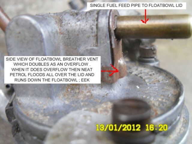

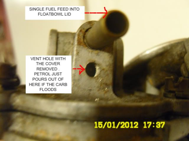

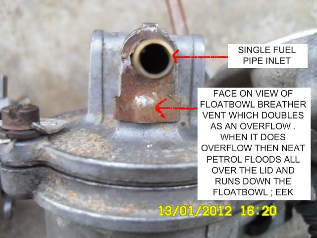

The early SU carb does not have that overflow to take the fuel away , it only has a hole where any petrol overflow is chucked out onto the engine  ; EEK ; EEEK ; EEK
The early SU carbs fitted to the Reliants had only a single fuel feed pipe into the lid and a hole in the lid with a little cover over it to prevent blockage ; as per
CARB ; OLD SINGLE PIPE FLOATBOWL LID ; SIDE ON VIEW ; SHOWING THE VENT HOLE COVER IN PLACE

CARB ; OLD SINGLE PIPE FLOATBOWL LID ; FACE ON VIEW ; SHOWING THE VENT HOLE COVER IN PLACE

CARB ; OLD SINGLE PIPE FLOATBOWL LID ; FACE ON VIEW ; SHOWING THE VENT HOLE COVER REMOVED

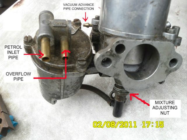

I would advise any SU carb owner to upgrade to the later 2 pipe floatbowl lid as per ;
CARB SHOWING LATER TWO PIPE FLOATBOWL LID
http://i423.photobucket.com/albums/pp316/fifer3w/CARB%20DETAILS/CARBSHOWINGLATERTWOPIPEFLOATBOWLLIDpic1-1.jpg
Reliant SU Carb safety advice
The vent / overflow pipe can have a length of fuel hose attached and taken to a safe position away from the electrics / exhaust  to the rear of the driver / rider .

was wondering what the second pipe was for when i polished mine previously. so just stick fuel pipe on and vent it low?
        can i have it in 20 Min's?
fifer
Posts: 1116
« Reply #5 on: January 16, 2012, 10:21:24 PM »
Yep , over the rear of the gearbox and to behind riders right leg and dump any excess on the ground .

If an SU float chamber floods that regularly and with such volume, then an overhaul might just be the way forward!I have used the original type of carburettor top over many years with no problems,really. If there is, then that's what the baffled bleed hole is for, and its then doing what it should do,in an emergency,not as part of its general function, Morrag
As have I since 1976 to about 1980 when I changed over after seeing too many results of leaking carbs.
Again I have to agree the normal general function of the hole is to vent the carb to stop a build up of pressure with the inbuilt secondary purpose to vent any excess away in an emergency.
Do you not agree that prevention of the effects caused by such an emergency should be taken into consideration .
The petrol will leak over the the exhaust so why not pre-empt the possible catastrophe by upgrading to a safer solution ? Smiley
