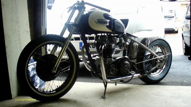

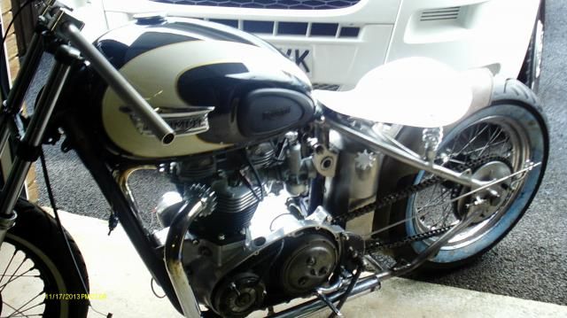

Remember this.
Not mine but i'm building it.
Not a lot done,But it's getting there.

Doesn't that look the business. Lovely work matey.

Hi Hunter, bike's looking sweet..........
The rear wheel looks Harley (Iron head sporty maybe?)
Is that a Triumph bolt-on 7" brake drum by chance???
Question if it is, with the chain aligned, did you have to offset/change the rim-to-hub to ensure the tyre was correctly aligned? (ie was the rim offset OK as it was?)
I've heard some folk move the engine to the left a bit to allow wider tyres to clear the chain, just wondering how this all lined up.

Thanks Andy,I have actually handed it back the the owner for him to complete.
Tony not sure what rim is off,And yes trump hub.
As for alignment the sprocket has a spacer behind it.
