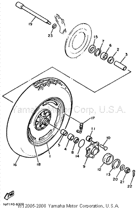

Anyone got an exploded diagram of a VMax rear wheel? FLC needs to see the layout of wheel bearings, spacer tube etc.

« Reply #7 on: February 06, 2008, 08:27:10 AM »
MM, Is this any good?
http://www.starmotorcycles.com/star/parts/home.aspx
http://i132.photobucket.com/albums/q34/pagan66/vmaxwheel.gif
V Max tyres.
Item Part # Description Notes Req
1 1UT-25338-01-JK WHEEL, CAST REAR WARM SILVER 1
2 2H7-25315-00-00 FLANGE, SPACER   1
3 90560-20295-00 SPACER   1
4 93317-32635-00 BEARING, CYLINDRICAL   1
5 90387-203H7-00 COLLAR   1
6 93306-30416-00 BEARING (B6304RS)   1
7 99009-52500-00 CIRCLIP   1
8 93102-25064-00 OIL SEAL   1
9 26H-25366-00-00 CLUTCH, HUB   1
10 90249-12167-00 PIN, SPEC'L SHAPE   6
11 1FK-25364-00-00 DAMPER   6
12 1J7-25319-01-00 SEAL, HUB DUST   1
13 93440-45022-00 CIRCLIP, OUTER   1
14 93210-68347-00 O-RING   1
15 93106-40027-00 OIL SEAL   1
16 94115-155U8-00 TIRE (150/90-V15 G526BW) UR BRIDGE- STONE 1
17 93900-00016-00 VALVE, RIM UR BRIDGE- STONE 1
18 29L-25398-00-00 BALANCER, WHEEL (10G) UN 1
18 29L-25398-10-00 BALANCER, WHEEL (20G) UN 1
18 29L-25398-20-00 BALANCER, WHEEL (30G) UN 1
19 1FK-25381-00-00 AXLE, WHEEL   1
20 90201-18620-00 WASHER, PLATE   1
21 90171-18043-00 NUT, CASTLE   1
22 91401-40040-00 PIN, COTTERPIN, COTTER (91401-4   1
23 92901-20600-00 WASHER   1
The Pagan
« Reply #8 on: February 06, 2008, 10:12:43 AM »
Could be, thanks.
FLC's doing some work with the wheel for me, so I'll let him know.
