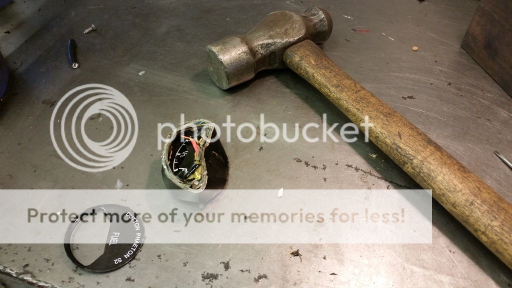

« Reply #3 on: December 12, 2015, 06:12:11 PM »
That's a very sore subject with me Merv. After spending a considerable amount of time calibrating a fuel gauge to the sender unit, I stupidly decided to just tweek one of the ends of the bi-metal strip...... you know just to make it perfect like Roll Eyes and after that the bloody thing was totally buggered, this was the result after some further technical adjustment Grin Grin
http://i390.photobucket.com/albums/oo343/PDSheridan/2015-11-21%2012.53.41_zps9n0nqdlx.jpg
fuel gauge
« Reply #4 on: December 12, 2015, 06:22:24 PM »
 Grin A man after my own heart! People rarely wind me up, mainly cos I don't particularly care what anyone thinks, but inanimate objects do it every time. The only time I swear is when I'm alone in a garage.
