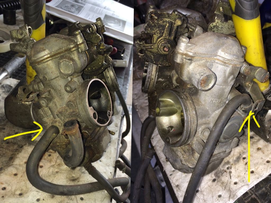

Just started to sort the carb on the XL600, and it has the worlds supply of pipes coming off of it!
Can anyone with a better knowledge of these carbs tell me where, internally, these two pipes come from, please?
They both still vent to air, so can they be capped?

http://www.cmsnl.com/xl600r-1986-usa_model7700/valve-set-starter_16046mg2891/#.VU9wSHCkqrU
Looking at this parts list I would hazard a guess that they are overflow pipes in case of a stuck float. Think it might be a good idea to have a look for an xl forum and see if there is any info there.

Cheers buddy. Glad to see I'm not the only one who goes straight to CMSNL for diagrams.
