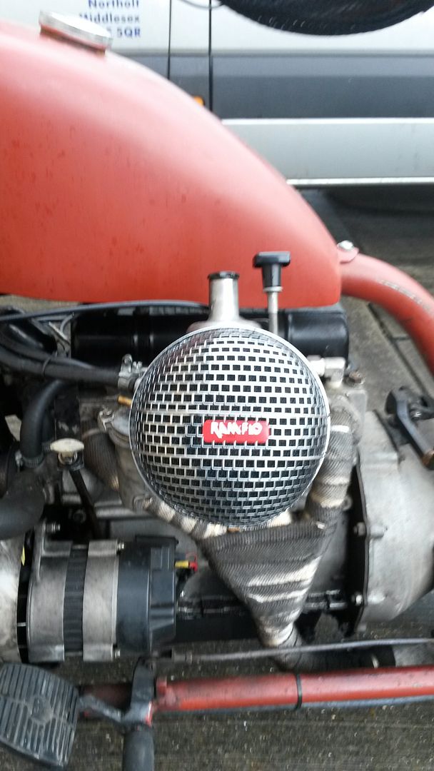

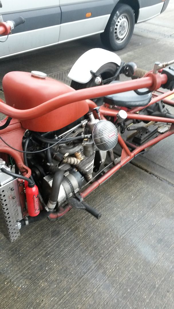

thank you gentlemen  Wink i have fitted it now with the oiled foam. its a ramflo unit for a 1 1/4" carb. haven't seen one mounted on a trike so needed it  Grin
  http://i1201.photobucket.com/albums/bb347/twistedspirit76/mobile%20pics/mankey%20monkey%20motors/my%20trike/IMG-20150316-WA0004_zps9pqy0zyq.jpg
oil or dry?
http://i1201.photobucket.com/albums/bb347/twistedspirit76/mobile%20pics/mankey%20monkey%20motors/my%20trike/IMG-20150316-WA0006_zpsr4l5s58c.jpg
oil or dry?
« Reply #4 on: March 16, 2015, 04:07:12 PM »
Smart!
« Reply #5 on: March 16, 2015, 09:19:33 PM »
That's nice Craig.
