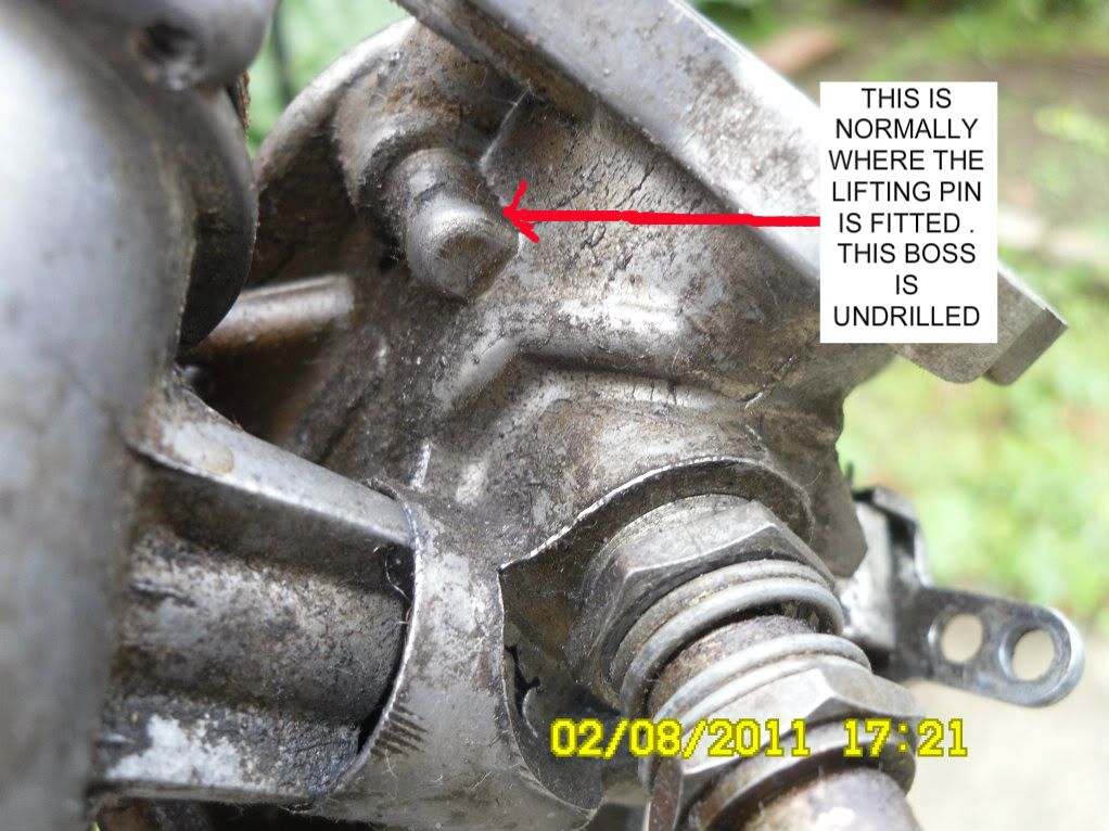

where is this lift pin ive been searching and never found it... did some hs2 carbs have it and some didnt??
 I think they all have a lift pin but could be wrong. The lift pin is located on the underside of the main carb body just to the right of the float bowl, and just forward of the left hand air intake bolt. its a small spring loaded pin, to set the carb get the engine idling at a normal tick over warm etc. then quickly lift the pin up if the engine revs drop and the engine stalls it is too lean if it rises and keeps on rising it is too rich. it should rise momentarily and return to a smooth strong idle quickly, then it is near enough.
Yes ,as per pic below .
http://i423.photobucket.com/albums/pp316/fifer3w/CARB%20DETAILS/CARBWITHOUTTHELIFTINGPINSHOWINGUNDRILLEDBOSS-1.jpg

« Reply #21 on: May 23, 2012, 09:23:39 PM »
yeah mines undrilled then like the picture, will lifting the piston with a screwdriver a tad do the same trick??

« Reply #22 on: May 23, 2012, 10:30:40 PM »
Could be a bit unreliable on the stroke /amount of lift. I dont think it is an exact science the lift pin set up but it as always worked for me on the sus. Single sus that is, the twins are another ball park, a hose and listen then, i always found it hard  on the MGBs setting up the twins. As with all things experience wins the day.
