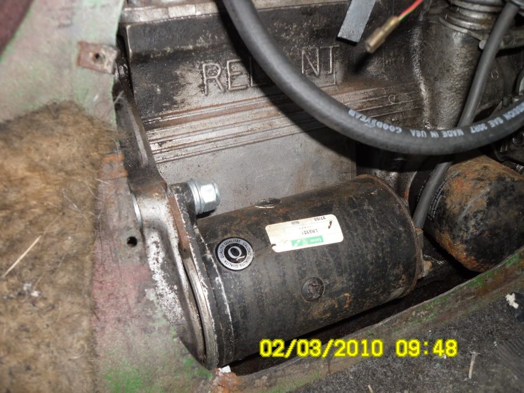

Yep  Smiley
Here,s one I did earlier  Grin
Click on photo to enlarge
http://i423.photobucket.com/albums/pp316/fifer3w/STARTER%20MOTORS/OLDSTYLEINERTIASTARTERFITTEDINENGIN.jpg
one for fifer me thinks..........Starter motor swop
You will need to swap the flywheel due to the different teeth but you might be able to use your old clutch if they are the carbon thrust type
I had an 1989 engine with the carbon thrust clutch , a bu***ed pre-engaged starter and the gearbox was also b***ed .
As I did not have another pre engaged gearbox or another pre engaged starter motor but had about 6 inertia type gearboxes lying about and a new inertia starter motor it was a no brainer decision .
On the starter motor / gearbox swap I did on that one above all I did was change the flywheel and clutch but I did not change the back plate and ALL I had to do was slot the holes .
I changed the box with the engine still in the car and then found that the holes in the pre engaged starter are smaller spaced than the 5 inch ? holes on the inertia starter so I used a Dremel to slot the plate insitu .
I then went into my hut and gave myself a darn good thrashing  Embarrassed

Swop the flywheel then , before fitting the replacement gearbox , try the new inertia starter on and see what you have to do to make it fit .
