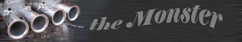

The first things that grabbed my attention were the 4 enormous Webber carbs sticking out either side. 48mm twin chokes to be precise.. and the nitrous oxide bottle on the back stuck out a mile! The combination of Rover V8 with the twin sprung LSD Jag back axle suggested that this was a thoroughbred. Someone totally focused on performance had built this and it reeled me in. My good friend Gazza jumped into his recovery truck with my cash in his pocket and zoomed off to Barry, from South London. He gave it a look-over and took it for a quick spin and called me, telling me it was a good buy. The fella selling it was a bit worried that I was disabled and was asking Gazza if I would be okay with it...HA, HA, HA!!!! Once it was home I sat on it for the first time and started making notes of all the work that needed doing.

After researching Webber carbs on the web, I was confident enough to tackle them myself. I bought a selection of jets off the web and spent 2 days with my mate 'Edd the Wrecker' tweaking. Twas good fun but I don’t think the neighbours would agree. Edd rode the trike around the block every time I changed a set of jets. 8 bloody jets each time. I slowly went back up with the mains while going down with the idle jets...We went past the optimum, and then back one, adjusting the idle screws as we went. The screws don’t adjust the ratio of the mixture at idle, just the amount. With no chokes fitted it's a bit of a pig to start and to keep idling at first now... pump the throttle 3 times before starting and hold the throttle gently for a few minutes before setting off. It was set by the shop to idle on its own, straight away, which meant as it warmed up it became far too rich to run properly. I also fitted the aluminium 6" polished bell mouths that I found on a USA drag race website, which come in useful as a leg rest as I’m getting on and off. Once I had the jets as near as I could get, I put it into 'Southern Carbs' in South Wimbledon for a final check and balance. Really helpful and cheerful chappies. They adjusted the timing and reset the idle screws after finding the jets to be correct before balancing them all. Runs much sweeter now, but it's still a little over-carbed. Apparently my DCOE carbs are sought after by classic racers and are worth upwards of £400 each, so maybe one day I shall Ebay them and buy me some brand new 45mm's. That is, if I don’t find a 4.6 lump, to go with the carbs, first. Ever since first buying it, I had so many different ideas for ways of carrying my wheelchair. It’s an aluminium 'lightweight rigid’, which means its lighter cos it doesn’t fold up. In the end I bought a 4-bike cycle carrier that fits onto a car, behind a bolt-on tow ball,
